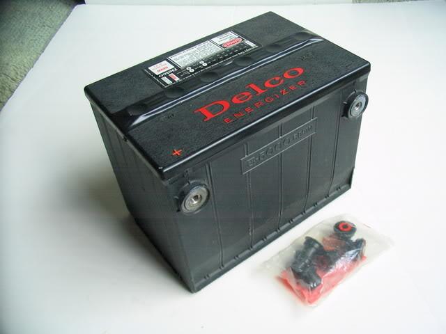

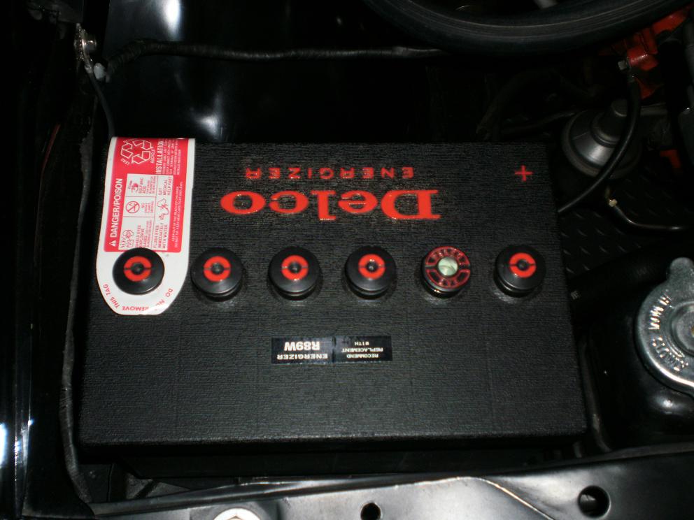

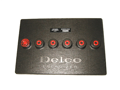

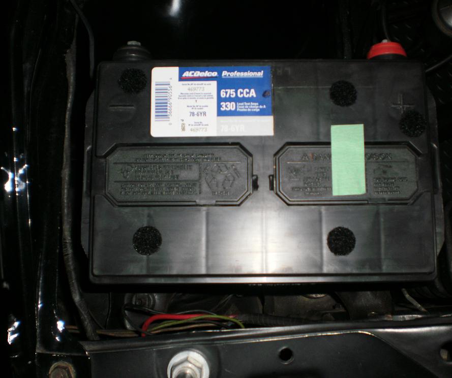

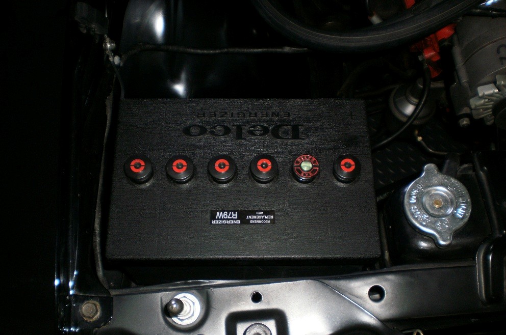

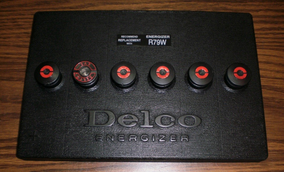

I recently restored my battery topper to look more realistic than the way it comes from the repro company.
I noticed that the NOS batteries had the &quot;<span style="color: #FF0000">Delco Energizer</span>&quot; in red were the repro is just plain black and also i was not happy to settle with a Delco Eye that was a fake on the repro were the NOS ones are a real eye.

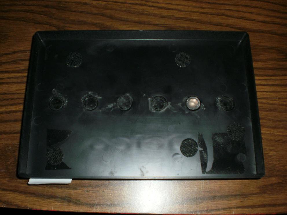

At a local swap meet i bought the real set of Battery caps with a real Delco eye. I cut down the Delco eye to fit on the topper so it would sit flat on the modern battery, i also added a strip of green painters tape on the modern Delco battery to give the eye that nice green color background.
Next i hand painted the embossed DELCO ENERGIZER letters on the topper along with the Positive+ marking. The Battery caps were all glued in with The Right Stuff gasket sealer along the sides as they are looser than the tight fitting repro caps.
Finally i bought velcro circles at the dollar store to insure a nice tight crab on the top of the modern delco battery and i also removed all the factory stickers along the side of the modern battery so all you see is black plastic.

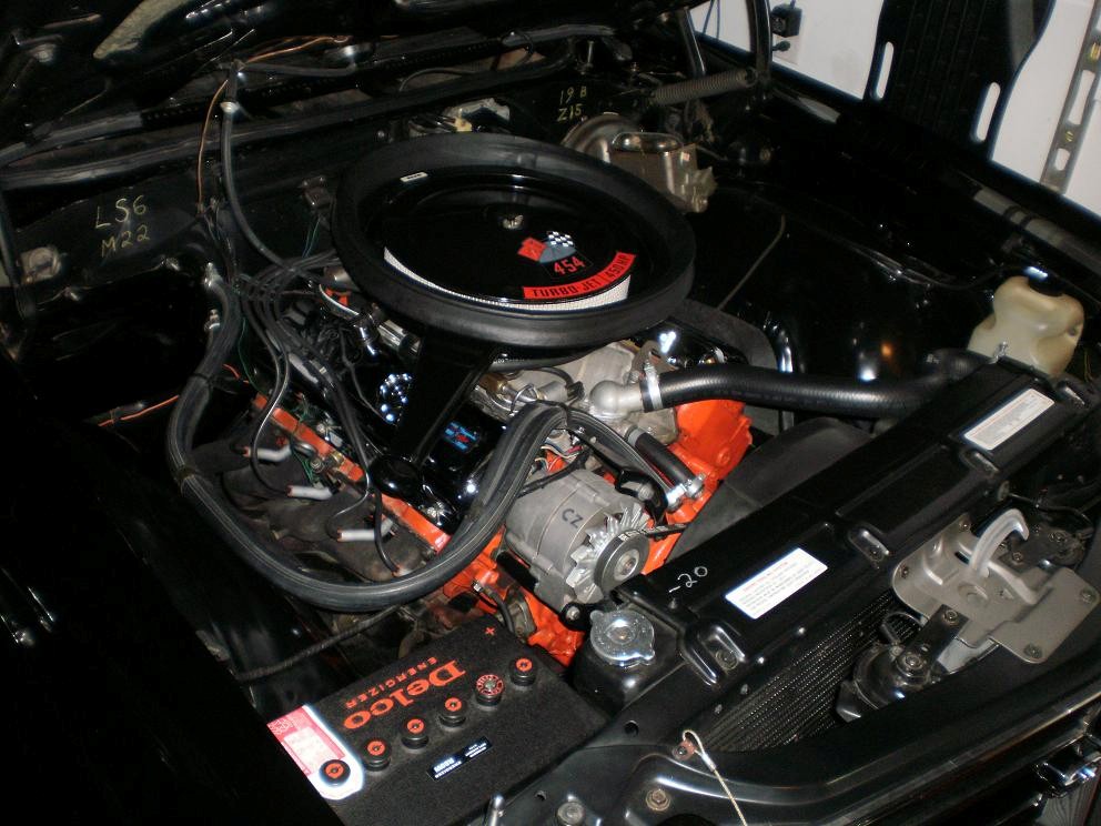

The end result is amazing, a lot of guys do not even know it is a topper anymore!
See photos for before and after shots and how an NOS battery looks, as you can see my topper now looks more realistic!
You can do this for the side terminal topper or top post topper.

Rick you are correct with your comments but i copied a R89W NOS battery as that is what the Sticker is on a Reproduction battery topper. See the first Photo of the R89W NOS battery.
I think the R79 battery had a smooth finish on the top were the R89 had that grainy look.

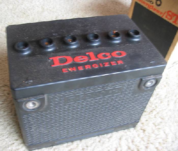

But what is confusing is i found this R79 NOS picture with the red painted letters/
I am guessing that when the batteries were new in the car it did not have the red letters but when you replaced the battery later on and got one over the service counter they did have the red letters?
Old 09-24-2011, 12:01 AM

Correct me if I'm wrong but I believe that white plastic &quot;Danger Poison&quot; tag is a modern warning label. The originals didnt have them. Kind of like the infamous Ford &quot;Caution Fan&quot; sticker found on all Camaros.
The topper modifictaion looks awesome, BTW.

The assembly line batteries did not come painted as you guessed and the service replacements were indeed painted. Assembly line batteries also had a different date code format from from the over the counter batteries for warranty purposes.
The R79W was very similar in appearance to the later R89W as the case was the same textured looking plastic. The R79 and R79S batteries were rubber cased exactly as in your reference photo. R89 and R89S batteries were also rubber.
