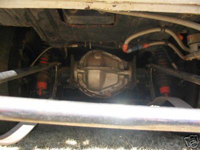

About 2 years ago I won an auction on Ebay for what was advertised as a 1970 Camaro ex prostock car that was built by SRD and last updated in about 1972. It had a 1979 nose and tail lights on it. After looking at pics of the Jenkins 70 Camaro when ZUL owned it I could see that the cars must have been built identical side by side. It had the SRD cage with side bars that ran to the firewall and the A-pillar bars mounted on top of them,and the support bars from the same spot on the firewall to the front subframe,the 3 link backhalf(ladder bars added later)with Dana 60,super tricks,airheart brakes,old pinto rack ect. The deal fell thru,and the car got sold and shuffled around to a few owners and I lost track of it. I placed a wanted ad on Racing Junk looking for the car and had a response the next day. The new owner has a ton of history on the car,and it is super interesting. Back in 1972 Joe Lepone's couson,a guy named Bob Demarco wanted to go pro stock racing. Joe told his cousin that he knew that there was a 1970 Camaro down at SRD that they were keeping there as a spare for Jenkins. He bought the car,and raced it for a few years,and then sold it. The car supposedly floated around the PA area with a Jenkins built 427 under the hood for many years. It seems that the car was probably not built for Jenkins,but somehow it ended up there. It seems that the car was orange at some point in it's life,and it was rumored that Brooklyn Heavy had a car built at SRD. Who knows.It was white when Demarco raced it. The car has what looks to be a non Camaro steering column,maybe an early Chevy 2,it was acid dipped before it was built at SRD,but still has a VIN number,and some of the original interior panels,most of the original firewall,most of the inner 1/4 structure,inner roof structure,floor pans,has a headliner in it,and aside from the updated nose and tail treatment it wasnt updated at all since 1972. When the new owner removed the 1979 rear tail lights,the holes for the 1970 tail lights were there,with just a strip cut out between the lights for the 79 lights to mount to. All the rest of it was stock under the rear bumper cover.

Here are some pics of the car as it sits now. in the pic of the back seat area with the passenger side wheel tub in t you can see the top of a post sticking thru the floor,thats the mounting bar for the 3rd link,a real Jenkins setup.

3-link rear suspensions were the primary "thing" for ProStock cars in the 70s. If properly set up it would launch the car like a rocket. But the problem were just to set it up. The pictures of this one shows an early setup.
Later they started to make brackets for the upper rod to move the rod sideways. I have seen some cars that could move the rod 4" in sideway adjustments. Reason for this was that if the rod were not in the perfect side adjustment the car would launch in a twist, in extreme cases resulting in lifting the left rear tire. This made it really difficult to dial in the suspension on different track conditions and eventually they moved to 4-link setups that were more controllable even though they were not as good as a 3-link.

Yup Mark,that definatly looks like it was built in the early 70's as a pro stocker or late 70's as a modified production car. I doubt it was an SRD car that was built for pro stock. In 70,a few of the cars were running the old bolt in bars,and by 71 most SRD cars had the type of cage thats in the pictures I posted. Notice how the door bar actually goes from the main hoop directly down to the floor mid way along the door opening right over where the subframe mounting ara is,then another bar extends foward from there and goes to the firewall where it is bolted to the firewall with a plate on the outside of the firewall that has a bar that is welded to the front subframe.The top driver's side door bar was aded later on. The bar that runs down the front windshield(a-pillar) doesnt go all the way to the floor,it mounts to the top of the bar that runs to the firewall. The drivers side bar on the car in the pics was added later. as far as I know,this cage wouldnt have been legal to run faster then 10.0 anytime after about 1980. Prety much all prostockers buit after 1974 were tube chassis cars.
As for the Jenkins 3 link,if you look at this car,you will see that the mounting bar is centered in the car. I believe his setup used a link that was actually more like a wishbone that acted to both center the axle and provide suspention.This car had aftermarket frame rails in the back,and the entire floor was cut out and a box was built to cover the 3 link setup,and that box was at least as big as what would be needed to clear a 4 link.
