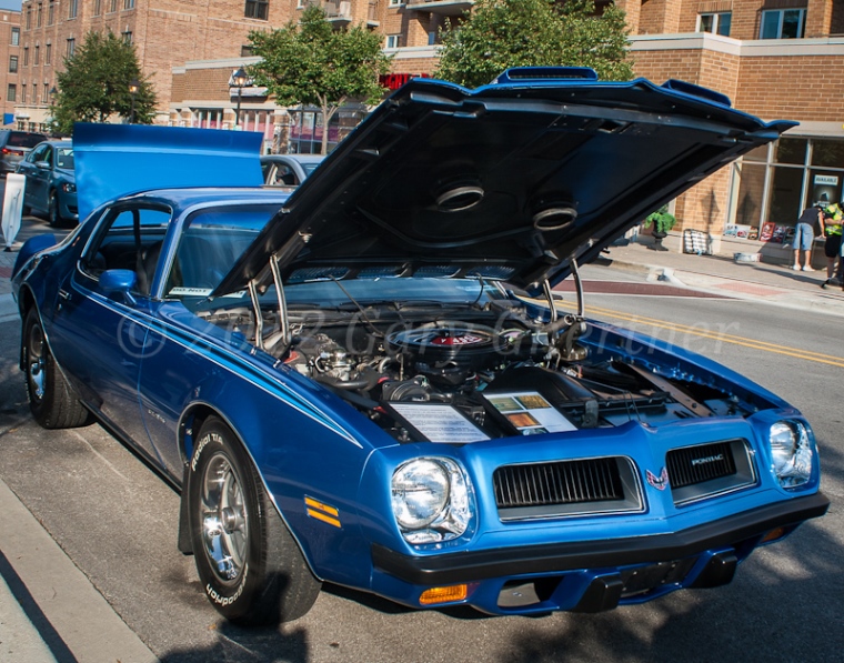

Steve is that a Formula, or was there a hood swap?

It was an Esprit and I added the ram air hood and the correct ram air air cleaner back when I painted it in 1994.
