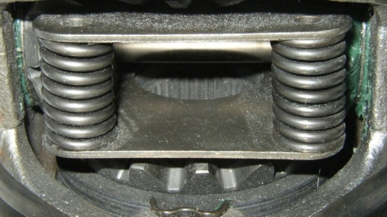

Ok.... so it looks like I have a set of these gears that came with a 174 posi unit I bought back in October. They have been sitting on the shelf ever since. How do I tell if the posi unit is a COPO unit without taking it apart?
Day 2 is Life.

Here are some photos of what I picked up.
Day 2 is Life.

I think the correct side gears have no 'flange' on the sides facing the clutch plates. Hard to tell from your picture.

Matt,
That is a standard duty 4-series unit, based on the posted pictures.
Here is a #234 unit to compare.
