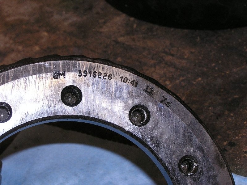

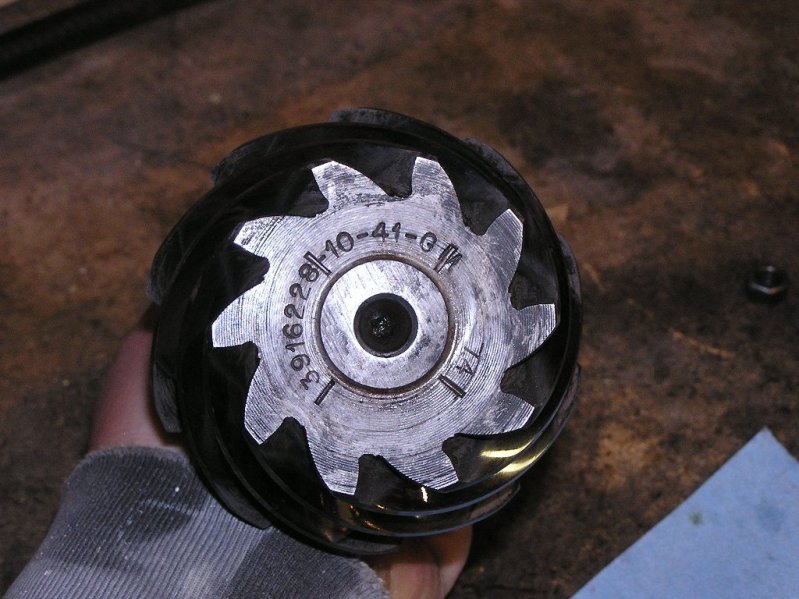

Ok.... so it looks like I have a set of these gears that came with a 174 posi unit I bought back in October. They have been sitting on the shelf ever since. How do I tell if the posi unit is a COPO unit without taking it apart?
Day 2 is Life.
Old 02-23-2011, 05:36 PM
Fast67VelleN2O's Avatar
Join Date: Mar 2007
Location: Mullica Hill, NJ
Posts: 4,115
Thanks: 7
Thanked 188 Times in 94 Posts
Default Re: BE 12 bolt questions
Here are some photos of what I picked up.
Day 2 is Life.

I think the correct side gears have no 'flange' on the sides facing the clutch plates. Hard to tell from your picture.

Matt,
That is a standard duty 4-series unit, based on the posted pictures.
Here is a #234 unit to compare.
