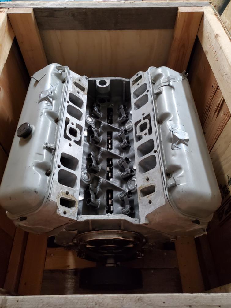

Here is a pic taken by Jon Asher in 1971. please note no winters flake & fuel pump boss.
Jake is my grandson!!

What's this ?
