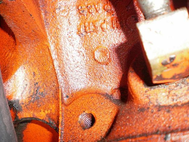

my friend has a motor running in his car and wanted some help in finding out what 454 he has. the pad in front of the passenger head is decked so no numbers there.
Casting at the back of the block by the bell housing is 3963512 K-7-9 which is a 454 dated November 7 1969.
now there is a Vin# on the pad near the oil filter which reads 10S189855 which breaks down as 1=Chevrolet 0=1970 S=St.Louis and 189855 would be the Vin# to ?
is this a 454 for a corvette or impala and if so what horse power rating is it.
the top end has a low rise GM aluminum intake with Hi Horse Square port heads but it does have the smaller oil pick up hole so i am guessing it is a 2 bolt main with the hi horse top end installed.
judging by the Vin# it is to high to be a corvette 454 so maybe it is a impala 454. what was the difference between the 390 HP vs. 345 HP 454.
any help appreciated.
attached is a photo of the Vin# by the oil filter.

here is a photo of the oil pick up hole.

Dan, the 345 horse 454 had the low lift hydraulic cam...I believe the same one used in the 325hp 396 motors. If this engine has the rect.port heads and 569 intake, then perhaps the cam was upgraded too. Since you said it was a running engine...does it sound like solid lifters..?? Since you mentioned the block was decked you may find that someone used the 2 bolt block and built it to LS6 specs...

the motor is in my friends 1970 Chevelle SS 454 LS6 car.
it does have solid lifters and cam.
we are trying to get as much info as we can as my friend will be searching for a 4 bolt main block soon and may want to take this block out and sell it. we clearly know it is not a matching motor to his car but if he pulls this motor out he wants to be honest in telling people what it is if he plans to sell it. i would really like to know were that Vin# would belong knowing it came from a ST. Louis Plant.
i also popped the valve covers off and both heads are different,one is a 3919840 D-3-8 and 3964291 F-6-9.
the only piece that matches his car is the correct low rise GM intake.the carb is a 3893229 3613 653 from a 1966 motor.
so as you can see this motor was pieced together but it does have good components to sell or trade off.

the first post shows the photo of the VIN by the oil filter.
my friend will decide sooner or later if he wants to go for the LS6 Components as he knows they aren't cheap.
now that we know it is a LS5 motor the question is what car would the 10S189855 belong to ? I've been told its to high of a number for 1970 Corvette's and it may fall in line with a 1970 Impala. can anyone confirm were the sequence of this Vin# would fall for which type of Chevrolet,Being it is assembled in ST. Louis?

...Vin# on the pad near the oil filter which reads 10S189855 which breaks down as 1=Chevrolet 0=1970 S=St.Louis and 189855 would be the Vin# to ?
Yep must be a B-Body Vin as '70 'Vette sequential six ran from 100001 to 128566 also not a '70 St. Louis truck either as their Vins had different year indicator digits..
