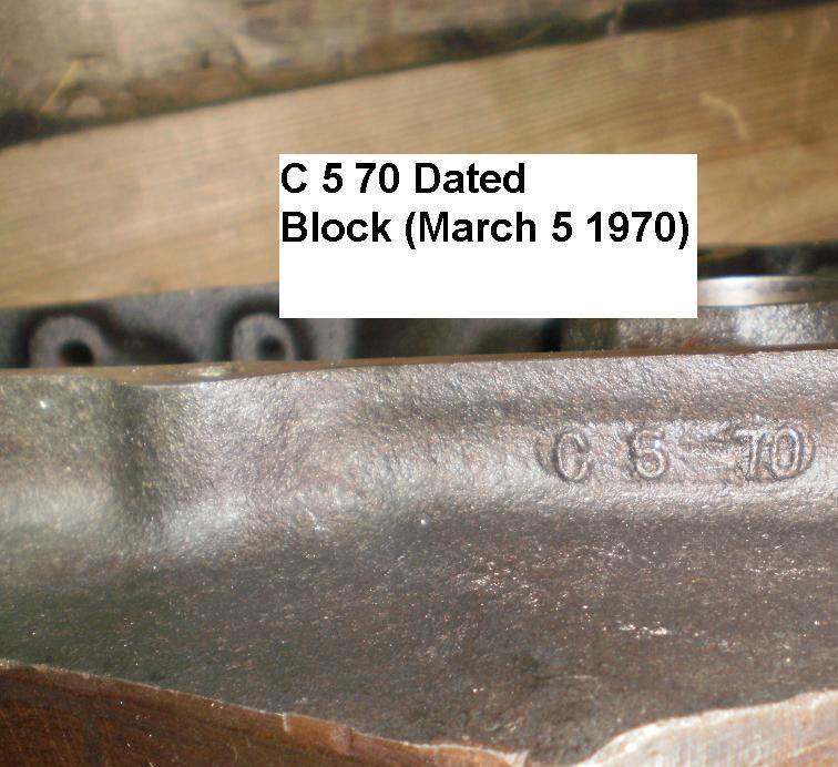

XXXGoldL34M20's Avatar
Join Date: Dec 2009
Location: Great White North
Posts: 4,082
Thanks: 135
Default Re: Is this a 3963512 casting?
XXXBlackLs6M22,
I forgot to ask. Can you show me a picture of where your date code is?
David
my date is on the oppisite side of the block.
see attachment.
