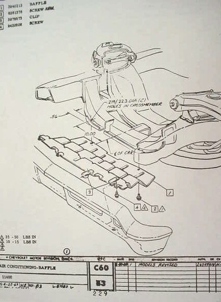

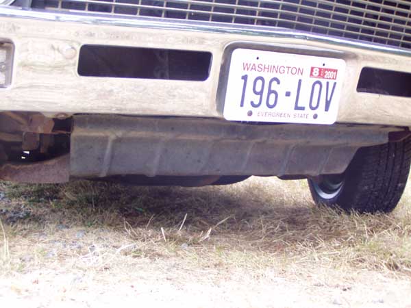

It might be the least of my problems, but who has that rubber strip on the top of radiator support?
(could not find at Ground Up or Classic)
thanks in advance for a lead
Attachments - The Supercar Registry 442150-novabaffle.jpg 441877-novadeflector.jpg

Small block Novas do not use the rubber strip. Your set up looks complete. Earl

I've parted out SB cars with AC that use that rubber strip on the top of the radiator support. I also have one if needed.

Small blocks do use the strip,it there to keep water off the back of the engine and firewall.

All Novas use the rear strip, but only AC Novas use the front strip. That front strip is used in conjunction with the special roll pan under the front end.
