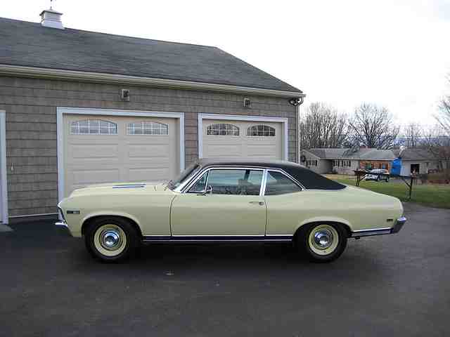

Old 01-10-2010, 06:42 PM
WILMASBOYL78's Avatar
Location: new york
Posts: 8,452
Thanked 2,354 Times in 628 Posts
Default Re: Nova Help NEEDED PLEASE!
Here is a 1968...

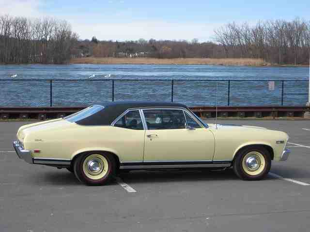

Old 01-10-2010, 06:44 PM
Location: new york
Posts: 8,452
Another of the 1968..

Old 01-10-2010, 08:16 PM
Location: new york
Posts: 8,452
The color does wrap around inside the sill...contact Wayne at NNN for the pics or what issue it was in...you may have the magazine already...you are a member, yes
