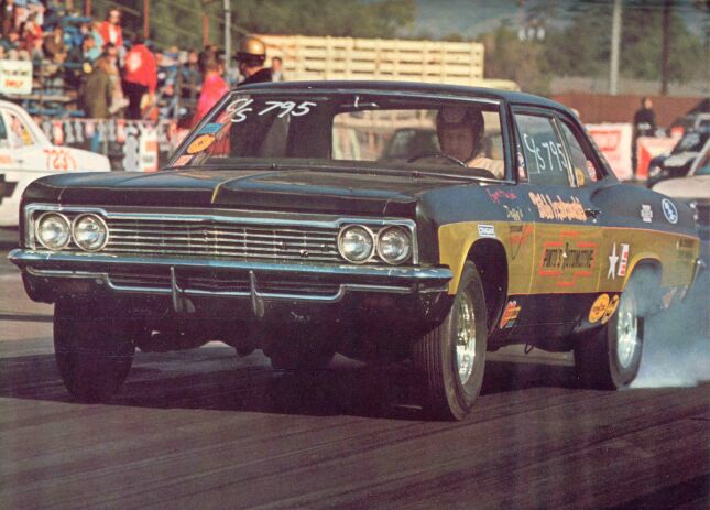

I have a 66 Biscayne 427/425 Biscayne and would like to know what class it would have been in in 1966. I have had mixed opinions and thought I'd turn to the experts on the SYC.

I'm pretty sure it was factored into NHRA's B/Stock according to it's HP/LBS.

Most I've seen were in B/S however I've got pictures of Bill Izykoski's car in both B&C/S. This car is one of the best known '66 Biscayne stockers. I also have a picture of one at Aquasco and one at York US 30 and both are classified A/S.
