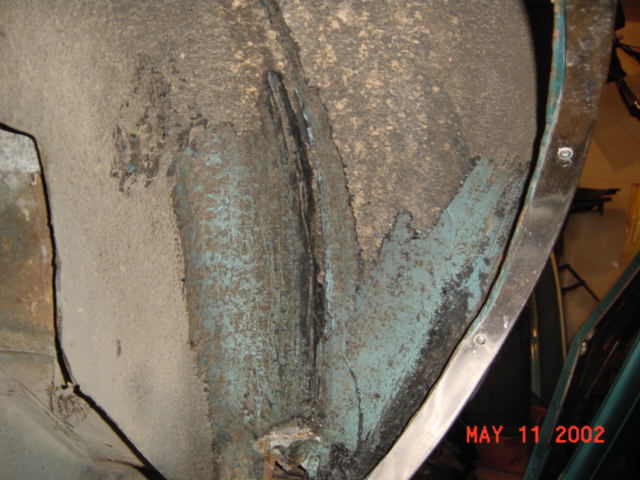

Does anyone know if they sprayed undercoating on the inside of the front wheel wells? This info would be for a 01d LA built camaro coupe. Thanks John

Don't know about LA cars, but my Norwood 08A (of 69) had a big "swath" sprayed inside each one.

Same here. Mine is an April or May car from Norwood.

My June built Norwood Z has the entire wheel well sprayed and the same with the rears.

Any pics?

Is there a recommended spray bomb undercoating product that closely replicates the original?

This is what I use. You will need to borrow a gun to shoot it. Will be somewhat close to original. You probably will not find anything in a rattle can with enough texture to it.

Hope we hear from Brian and Shauger on this subject.
I would be very surprised to find that front wheel liner undercoat in any amount was standard ???????
The 70-73 Camaros (both mfg plants) did not recieve ANY front undercoat......!!!!
Good call Mike,used that stuff years ago on my truck and it's close to the factory look as your going to get.

None on the front of my 28K mile Z/28 and just a couple inch wide stripe on the rear wheelhouse seams.
