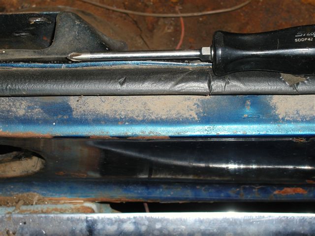

In the plant, the Fisher Body spec was to place the cut-and-trimmed joint centered on the latch; we used a small bead of pumpable black sealer/adhesive applied from a flow gun all the way around the gutter before rolling the seal into place, and used the same sealer to glue the cut ends together at the joint. Photo attached of my original 02D Norwood '69 joint.

Old 04-24-2008, 04:12 AM
Lynn Lynn is offline
Location: Oklahoma
Posts: 7,980
Thanks: 115
Thanked 3,770 Times in 1,586 Posts
Default Re: Trunk Weatherstrip
My 08A Z/28 had the joint about a foot left of center.
Also had black adheasive.
Thanks for the pic John.
