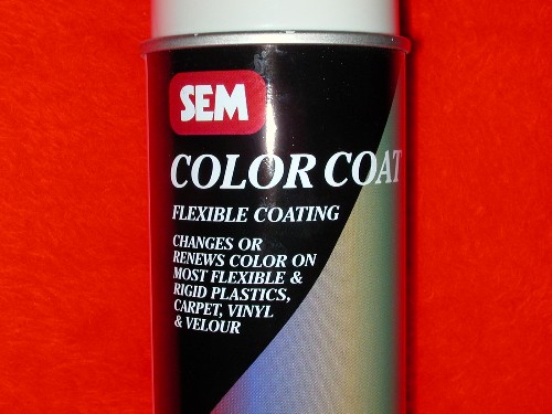

Darren, Here is another excellent product that is excellent to use and is inexpensive for small jobs. Go to your parts supplier and ask for SEM Color Coat Flexible Coating, I have used this also to do the plastic arm rest bases for my 69 Z with white interior, the super white #15103 was a perfect match for my white interior. I am not sure what or how many different colors of blue they have....it's worth checking out.

I have found for hard plastic stuff like kick panels, backs etc, lacquer spray cans work great. For the slightly flexible stuff the SEM stuff works great.

Darren, If you can find the SEM product in the right color, that sounds like the easiest way to do it, but if not here's another suggestion. If you can find the original PPG formula number for the interior color, you can have it mixed in laquer, then add a flex agent PPG sells. You'd have to spray it yourself with a detail gun, but I've done this many times on plastic and vinyl interior parts and they turned out great.

Just ran across this SEM paint chart ...
Looks like Pacific Blue might be my match...
