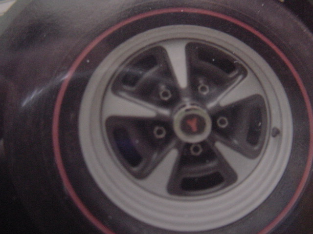

I'm sure this stuff has been covered before, but I have a few 68 Yenko Camaro questions. I know what I think are the correct answers, but all three of these questions have started a debate among Yenko experts, so, if you have any thoughts please chime in! I'm trying to get my car ready for judging at Vettefest and want to make sure I get it as good (correct) as I can prior to the show...so here come the questions:
-What is the correct Holley carb list number?
-The Pontiac Rally II wheels: 14x6 or 14x7? And the code?
-Lug nuts: Stock Chevrolet lug nuts, Pontiac Rally II lug nuts, or ???
Any input is greatly appreciated.
Thanks!!
Colin

I don't know the carb number, nor the wheel codes, but I do believe they were 14x7 wheels and used the Rally II style lugnuts. Here are 2 original photos of a 68 Yenko taken in 68 prior to the car's delivery, while still in Canonsburg. They're blurry, but hopefully will help you out a little.
Joe Barr

Joe,
That is awesome! I guess that settles the question, or at least gives me a decent photo to use if I get into any more arguments over the wheels and lug nuts
So, I am assuming they would have used trim rings (as is the accepted practice), but this car didn't have them because it wasn't prepped for sale yet??
Thanks!
Colin

Joe,
Thanks!
Colin
I don't know about that... I have photos of several cars WITHOUT trim rings, including one that was used for advertising purposes, so I would almost thing no trim rings was more the standard practice than the exception in 68. Yenko was buying the wheels to replace the standard steelies, GTO's didn't have trim rings, trim rings cost extra...and we all know about Don's thoughts on spending extra money...would make sense to say he likely didn't use them unless the customer specifically requested it. One oddball thing I should note, is I have some pics of a 68 Yenko (possibly the same car as in the above photos) with trim rings on one side, and none on the other... I'm guessing they were deciding at that time if they were "necessary" or if they could get away with selling the cars without them. This is all of course total speculation on my part, just using old photos as a guide. Compared to the 69's, it seems like there's still alot of unknowns when it comes to how the 68's were equipped and sold. -JB

The thought to be logic was that you could leave the dealership, go to the strip, go through tech, and not have to remove the trim rings.ie: race ready off the showroom floor.

I've got promo pictures of one of the bronze '68s in Florida with trim rings.
