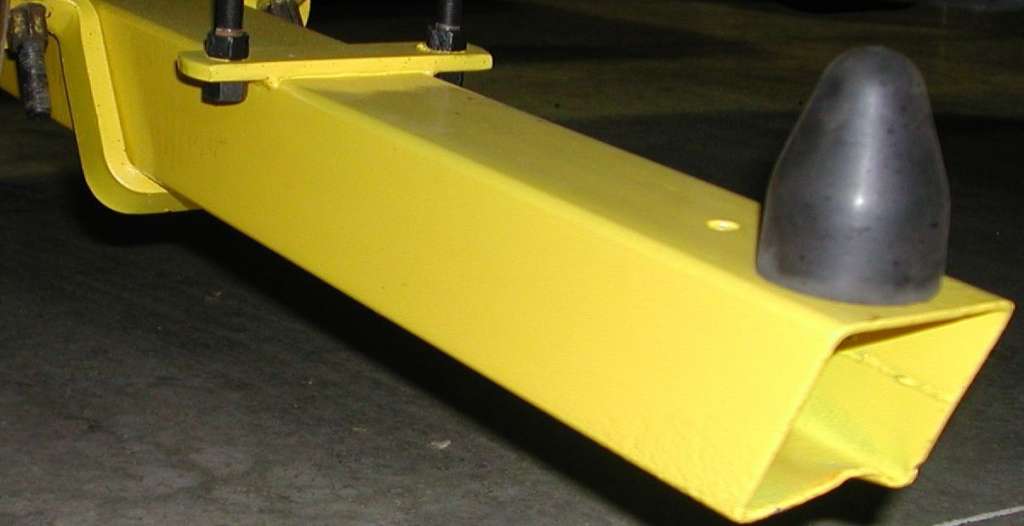

OK,
I finally found a great pair of original day 2 traction bars
with the long backs for that day-2 look I'm after for another
project. I have two fast questions and hope someone can
help. What is the correct yellow color? These were painted
red way-back-when. Where can I get original style J-bolts
and nuts? Mine are missing. Are they still available?
Anybody got an old set of J-bolts just lying around and in
dire need of a home?
Steve

Paint them daytona yellow and the j-bolts are availible from Summit.

I had the J bolts made at a heavy truck suspension shop and they were much cheaper and better materials than summit etc.

I call it "obnoxious yellow"...I will check to see what yellow we used to repaint the Lakewoods on our 70 black car..
wilma
ps..you can also get new replacement snubbers for the ends..

Nuch do you know the part numbers on the Lakewoods ?
Original part numbers from 1974 Lakewood Catalog
#21110 67-69 Camaro, Firebird, all Chevy II
#21120 70 1/2-73 Camaro, Firebird
J-Bolt Kits #20580 or #20560

I have my Lakewoods painted Daytona Yellow on my Z

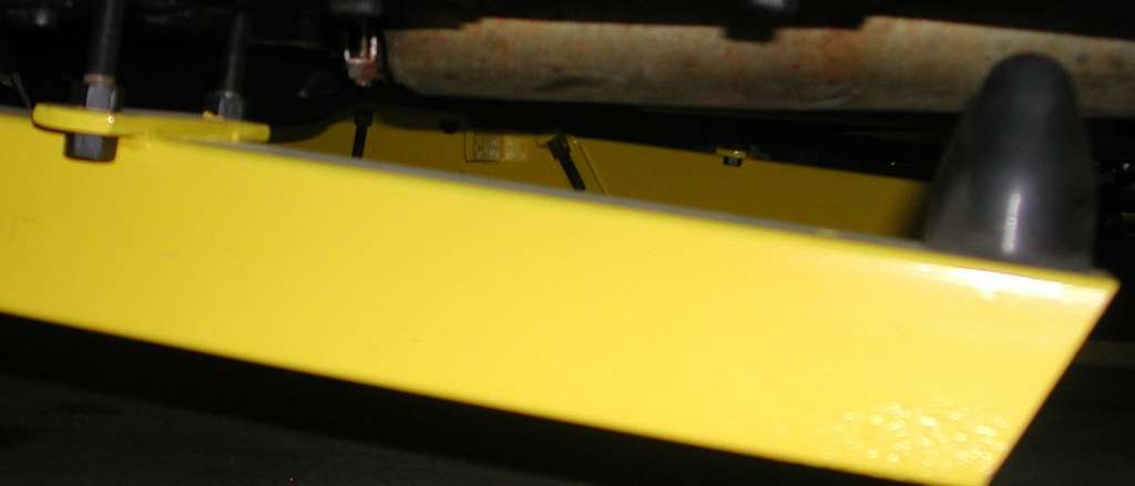

Took some photos of the Lakewood's on our 70 car...
wilma
