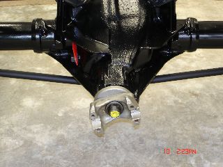

I am having the original "BE" rear completely rebuilt...
....should I powder coat the housing...or prime and paint the housing?
...I want to make sure the numbers and dates are still visible.

I primered mine then painted it and am happy with the results. Here is a shot of the numbers after the priming, they are still easily seen. I dont have a closeup of the numbers after painting, but they are still easily seen.

Here are some shots of the rearend in general to show the shade of black that I got by spraying.

last one
