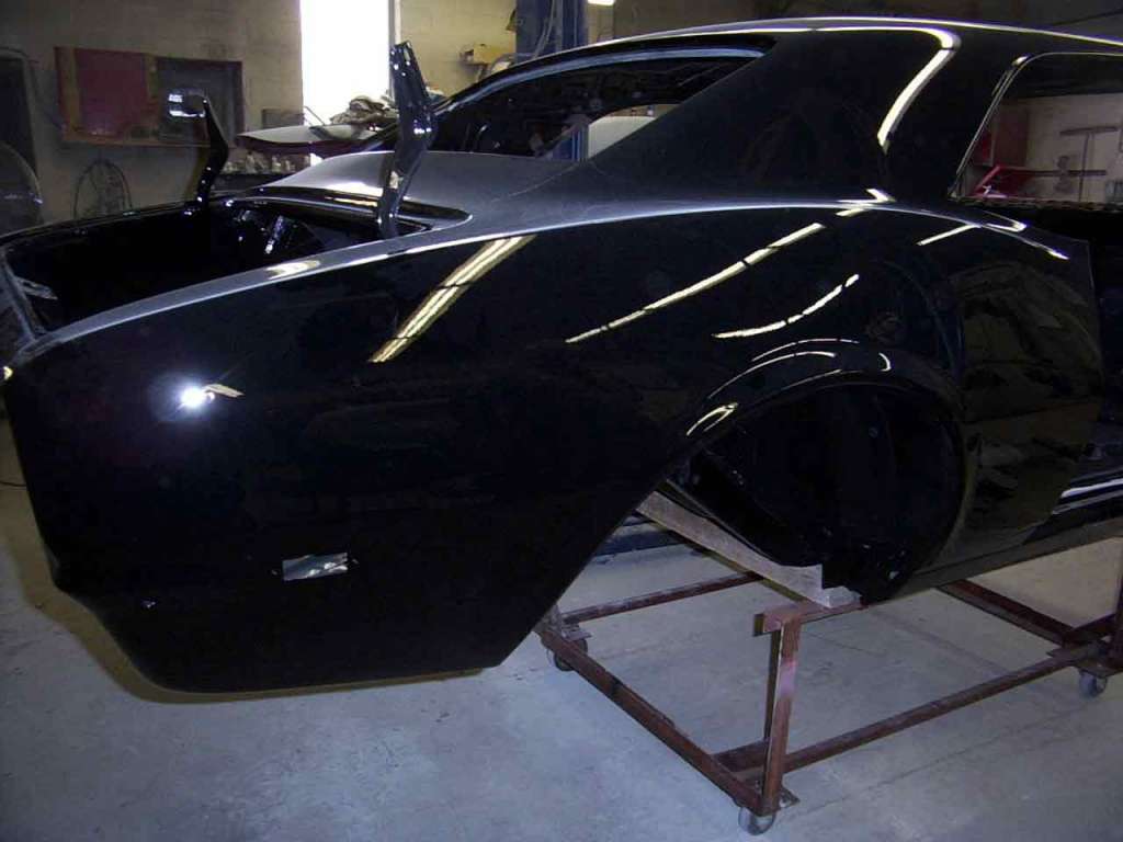

Its finally painted and I am now puting it back together
take a look

Looks nice Peter!

Very nice Peter! Who did the paint work for you?

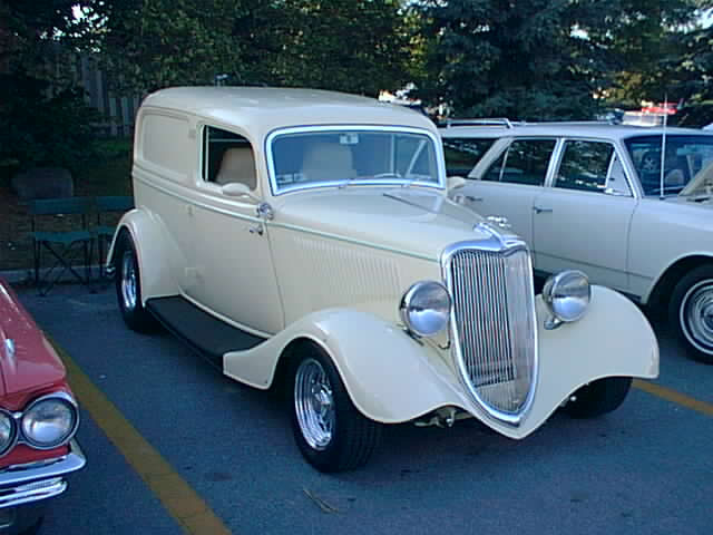

The car is being done by The best Canadian body shop in the business or at least I think so (Brooks Rods ) in Guelph ontario he did my 1934 steel sedan delivery hot rod and my L78 7o chevelle. He does nice work. The willies in the back ground in being redone by Hugh because the owner
was not satisfied with the butcher who did the body on the car
and now Hugh is fixing it right expensive when you do it twice. He has 3 in his shop
one is his that he is just about finnished (Whow).

I am includint a pic of the 34 ford
