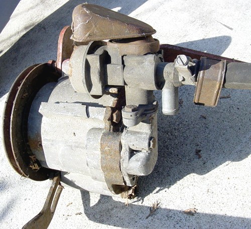

I know this isn't a Camaro item but....
Can someone Identify what application this smog unit came from?
Ive had it for years sitting in the shed; just want to determine what I have...

Another view...

Last image...

I'd say it's from a smallblock mid 70's corvette w/those brackets.
That doesn't look like a deepgroove pulley either.
Can you read a part# behind the diverter valve as well as the part# & date on the SMOG pump?

Default Re: ID needed
Ill go look....
On the date code, where is that exactly.
Ive never seem to find them every time...

Look on the bottom of the SMOG pump,for a machined aluminum boss that should show something like 21892S.

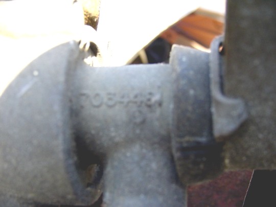

Divertor #...
7054481
Gotchya!
Here it is!
125 9 1S

Since I never owned a small block vette, are they short or long water pumps in the MAKO SHARK bodies?

Corvettes were all short water pumps.
