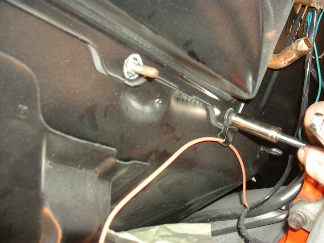

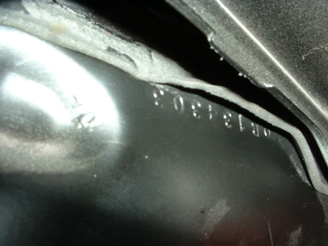

I was looking at some partial VIN stampings and it sure looks like the partial VIN on the engine is also the exact same stamp used on the hidden VIN's on the body. Is this a known fact? I know the transmission VIN and engine VIN should be the exact same stamp but I wasn't sure if the engine/trans stamp would match the hidden VIN as well.

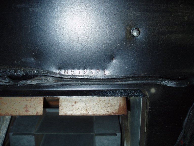

It is usually the same sequence. See the attached photo of a 72 Trans Am. It goes Year, Plant, Vin sequnce: "2N519898"

JohnZ could certainly give us a definitive answer on this, but I will go out on a limb and say the two body stamps were from the same unit. However, the partial VIN on engine and trans were a smaller font, so could not be the same. I want to say 3/16 on the body numbers and 1/8 on the engine/trans. I am almost certain JohnZ recently posted something about the body stampings on the team camaro site. It was a type of roll stamp and done by machine, not with a gang holder like engine and trans.
I just went out in the garage and looked at my body stampings and they appear identical, except the one under the blower fan is upside down. The fifth digit on mine is somewhat out of place about the same amount on both of mine.
