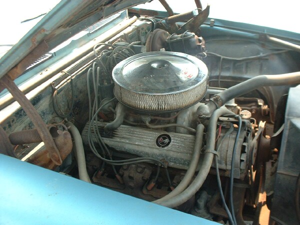

Darren, I don't think you need that bolt or clip on a Z. The hole where it would install was never tapped on my 28K mile car. Check to see if yours is. I have looked at pictures of serveral untouched original cars, no clip... Sheet M3 in the assembly manual does not show one, but it does show up if the car has AC. Could this be the next "Caution Fan" sticker on a Z/28.
I followed your progress over the winter of your car, it looks great. Keep up the good work.
Mike
Attachment is not my car, but 18K original.

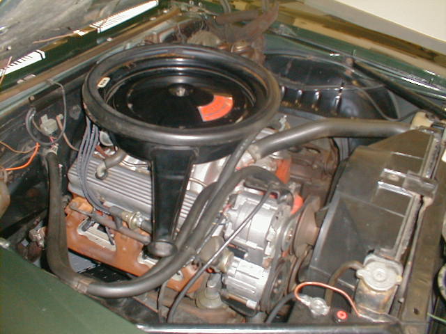

Default Re: BOLT! Heater hose bracket to alternator bracket.
One more picture.
