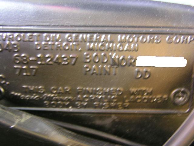

Here is a 68 Yenko Trim tag. It is different than other 68 Trim tags. This is a telling factor on a 68 Yenko or 68 COPO 9737 car. If you see a 68 with this type tag you should pay attention and hopefully save it from any harm.

68 Yenko Tag that Charley posted (top) and a standard 68 Camaro Trim Tag below it. Like Charley says, If you see one like the top one pay attention and save it from harm

Thanks for the standard tag for comparison.
