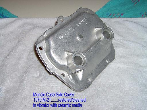

What is the best way to restore an aluminum intake so it retains the original finish and texture?

Attachments - The Supercar Registry 92934-Shifter Mtg Brkt.jpg 92932-MuncieTailhousing.a.JPG 92931-MuncieSideCover.b.JPG 92930-MuncieSideCover.a.JPG
