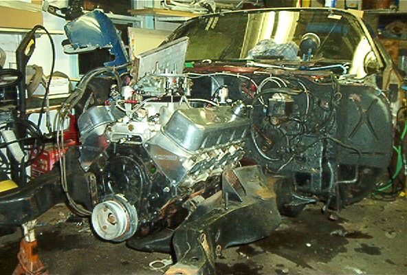

I just purchased a new car to go racing with.I dont know what I want to do with the bird,maybe a street/strip cruiser after the resto,but I think it's hardcore racing days are over.I am putting the drivline into a mini tubbed 1996 camaro.I am attaching a pic of the 96 camaro which I just bought.It is a super clean V6 car with no Ttops,roll up windows and no frills.It is also white with a bacl interior.It isnt an old school supercar,but with a 427 bigblock under the hood it will cary on the tradtion.
