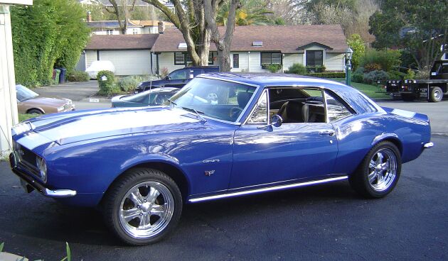

"Nothing more than a plain Jane six-banger"
I don't know if I would call it plain jane. Pretty nice looking.
[/ QUOTE ]Of course I was being facetious. This is our "plain Jane" we're currently working on.
Jeff
