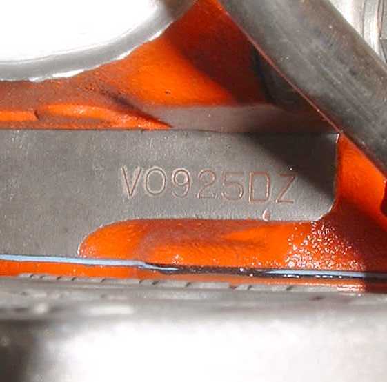

This time with a 67 Z28.
http://cgi.ebay.com/ebaymotors/ws/eB...tem=2422076684
10D X083
67-12637 LOS 4264
732-Z D-2
EX 2LG 3BSDL
4L 5BY
Only two problems, three if you count it being a LOS car. One the first batch of Z's weren't built until the last couple of weeks of decmber 66, and two the 4L code on Z28 trim tags wasn't used in October of 66, since there weren't any Z's at that point.
Plus it was an LF7 M35 car 2 months ago.
Aren't registries wonderful.
Mark C.

Don't know. Haven't seen the tag. There's no image on the ad page. It's tough to stamp another set of numbers on the tag, due to spacings and fonts so I would guess it's a repro tag.
Trying to clone a 67 Z28 is almost as tough as a Yenko. Most if not all of the VIN's are known.
Mark C.

You talking about the orange and black convertible? Nice looking car but:
ZL2 hood is not original, stripes are incorrect, only Z28's Z10's and Z11's had Rally stripes. Stripes are painted as if they were dealer added since the rear lip of the trunk lid has the stripe on it. Disc brake master cylinder is wrong, can't see if it has a rear proportioning valve, the A/C suitcase is from a Firebird, repro air cleaner, wrong valve covers.
Not to say the options didn't come on the car, just they aren't "correct" now. The engine code appears to be a 69 L48 but it has a typo in it, and the ad says if has the VIN stamp on it. It doesn't say its on the pad but implies it is. It should not have the VIN stamp on the engine pad if it's a mid March Norwood car, and they are almost impossible to see down by the oil filter with the engine in the car. Not enough info in the ad, or pictures to determine if it is or isn't an SS.
