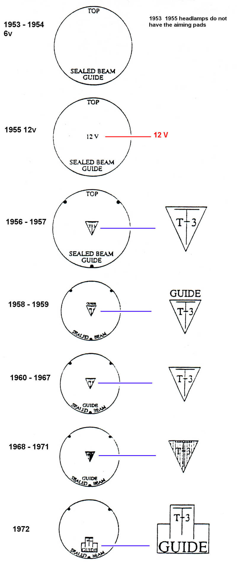

I am looking for a correct set of T-3's for a 1968 COPO nova which I have entered for a Gold Spinner at the upcoming Chevy VetteFest. Last weekend, I hit the Long Beach High Performance swap meet and found 1 headlight with no lines inside the T-3 triangle. I have two already which have vertical lines in the triangle and the dates of H 3 7. I plan to hit the Pomona Swap meet this weekend and continue my search.
Can anyone tell me which is correct? Vertical Lines or No lines? Also, are the dates codes diiferent for 1968? I found a B 8 date also?
Or Will the judges even look at the headlight details?
Thanks for your help !!!!

Guys, here is a list of the headlight useage for GM cars from 1953-72.................RatPack..............

Here's what I found on the T-3 in my '69 Nova. Inside the triangle, the vertical lines. A pebble grain inside the letters T-3 and the Large T. At the top, embossed to the outside, J75. Top left, below the aiming tab, stacked vertically, 8205. Top right, same location, just the number 2. Both those locations are embossed on the inside of the glass. On the back of the light is a stamping in red-orange. The top line reads CO2. The middle line is a little smeared but appears to be D 8 26. And the bottom line is simply 12V. I'm almost certain this light is OE to this Jan 4, Ypsilanti car. For what it's worth!

Tommy, I have not seen it in print, but I was told the date codes are on the front/top of the headlight. Can anyone verify?
It appears to remain consistant with the headlight usage data posted by RatPack.
