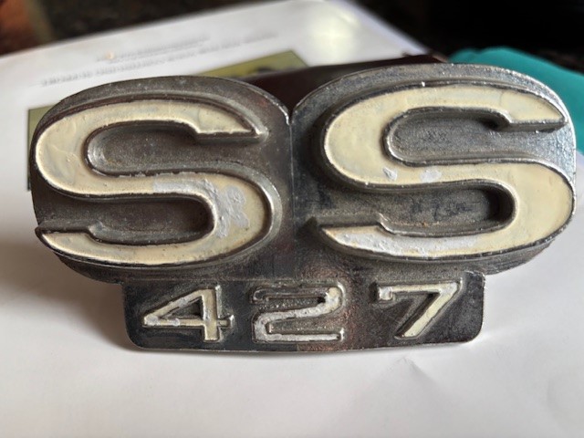

is there any evidence of 66 or 67 COPO Chevelles being produced with the 427 engine? Also, was it possible to order a Malibu with a 396 engine or did that automatically require it to be a Super Sport model?
