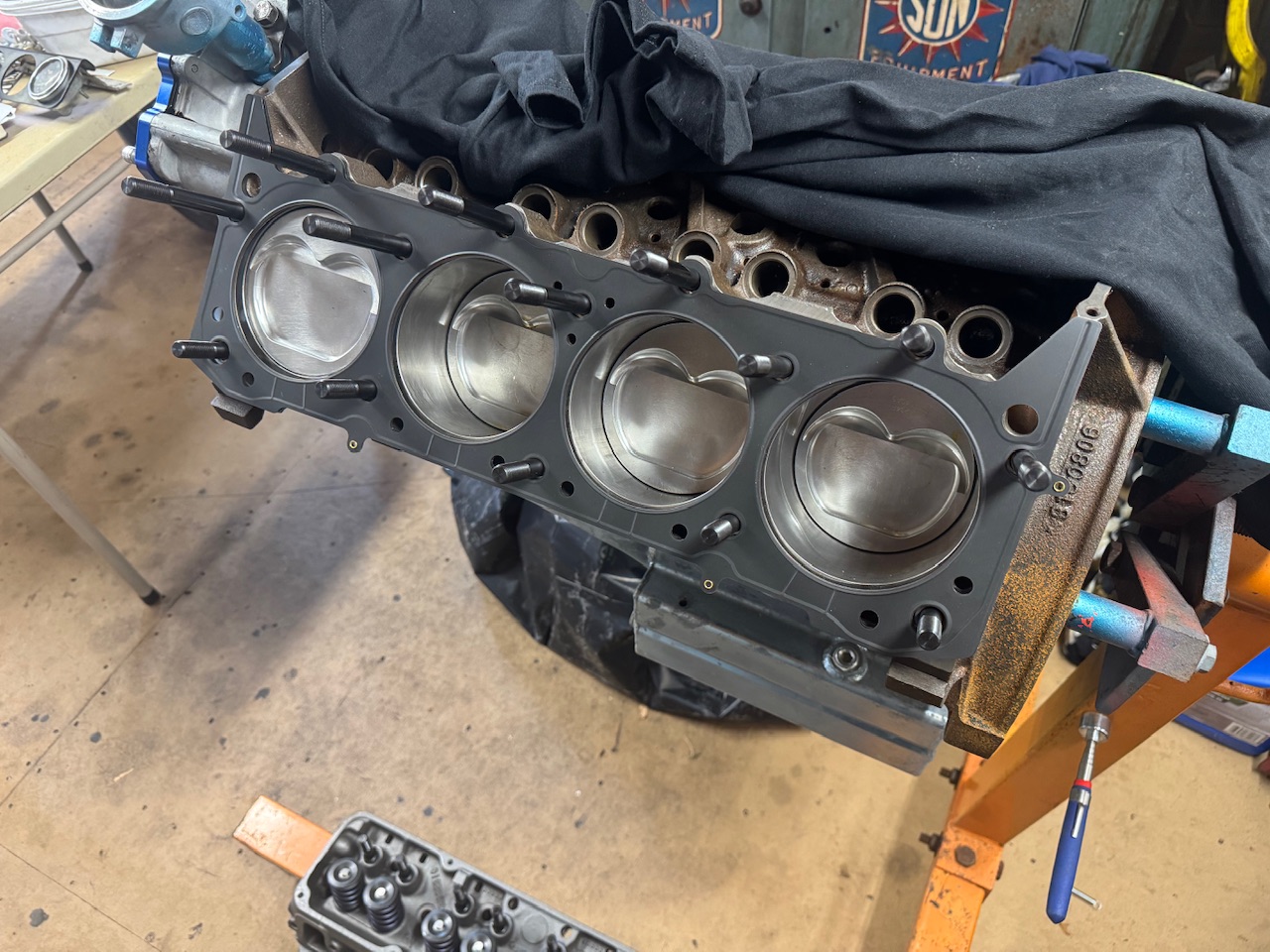

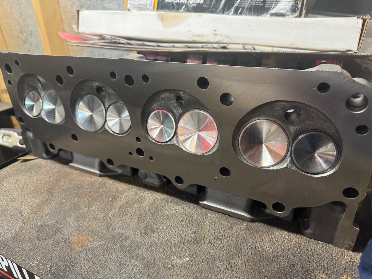

Well. Things only change if you work on them. So today I was able to spend some time on things.

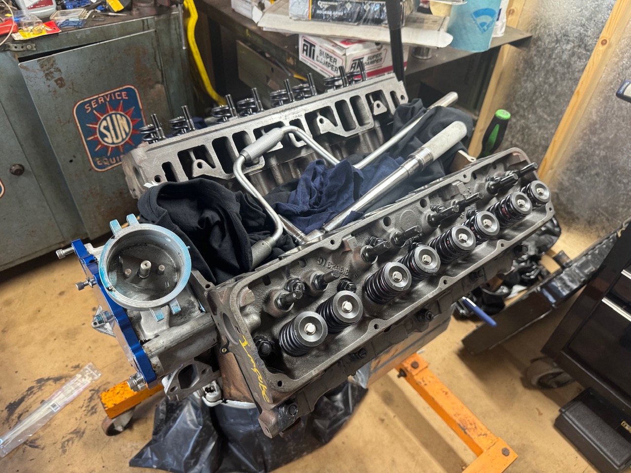

The Milodon head studs finally showed up. It took forever to get these sorted out because first their height was wrong, then they sent the wrong width studs, then I finally got everything right. After cleaning the decks I got the heads dropped on their dowels and slathered in arp lube. Then tightened everything to 80ft/pounds. Except the lower corner studs. They went to 65 as they’re known to crack on the 1970 specific heads. AMC actually recommended a different torque sequence on these heads(which I followed).

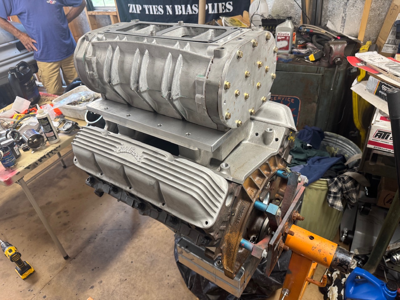

I needed a little motivation after the heads were down so I got the intake down to see how much it needed to be cut. After that I dropped the blower plate and blower into place and marveled at it for awhile. Then I sent pictures of the intake to the machine shop and took a ride there to drop it off. He’s going to get it back to me Monday after an initial cut to see how much more it needs.

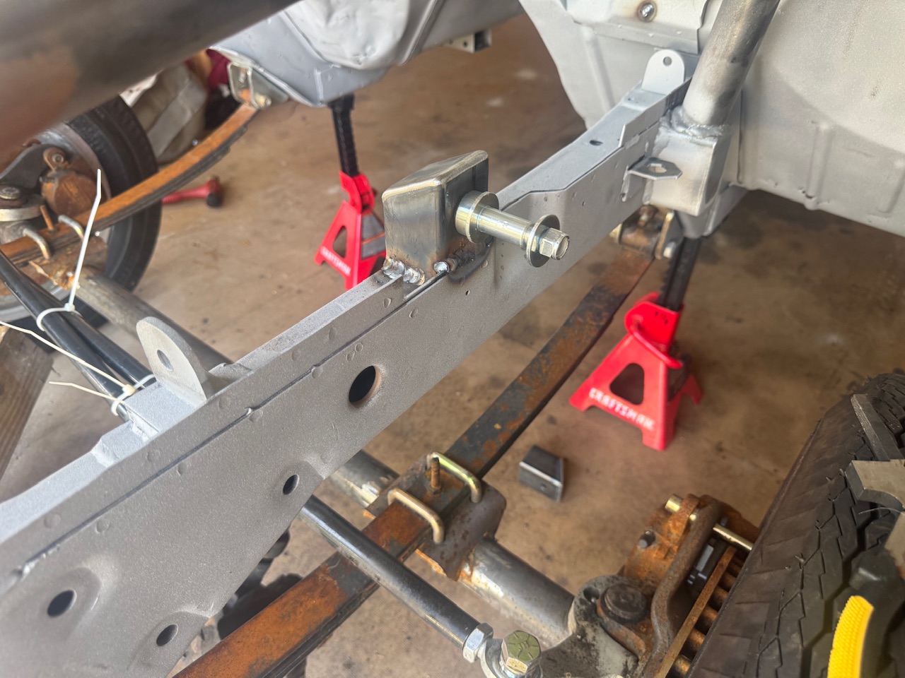

Then my dad and I got the front axle back on the car. I need to modify the front spring shackles a little for proper clearance. So I’ll bring them to work next week to trim them down. I was going to be done for the day but my dad and I started looking at all the holes in the firewall. And then I started the generator to run the welder, and welded most of the holes shut on the firewall.

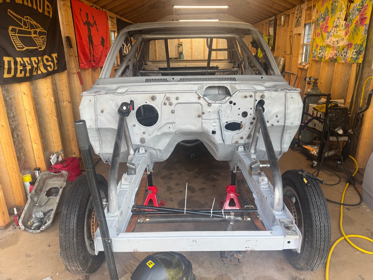

I also ordered a rear floor pan for a Nova, and a front floor pan for a javelin. Hopefully that’ll give me enough sheet metal to weld the floors back together. Pictures of that will start once the car’s in primer next month. I’m waiting for the humidity to go down some into the fall.

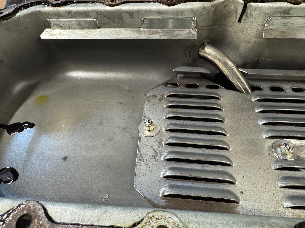

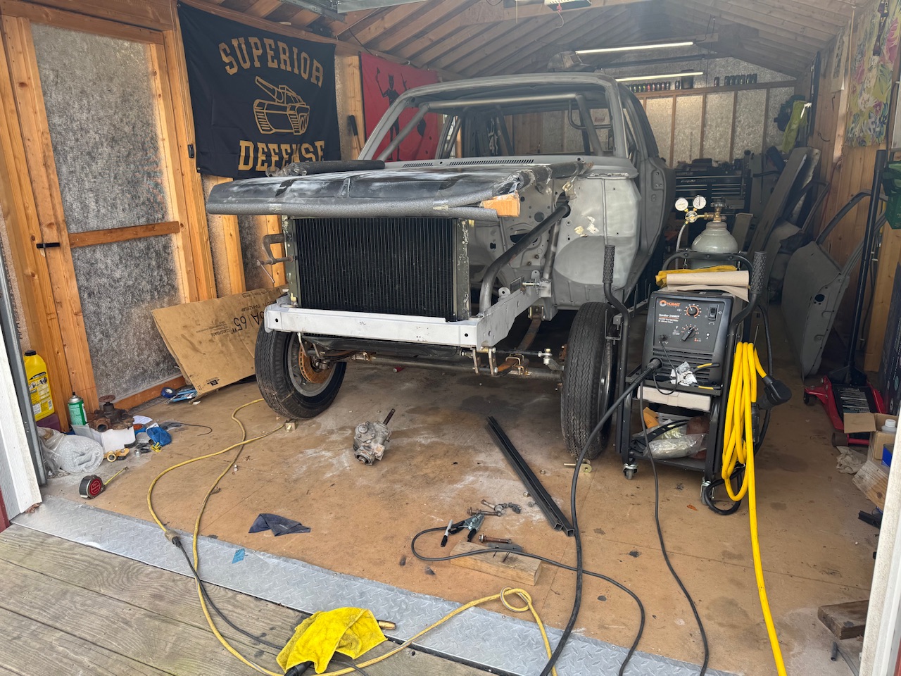

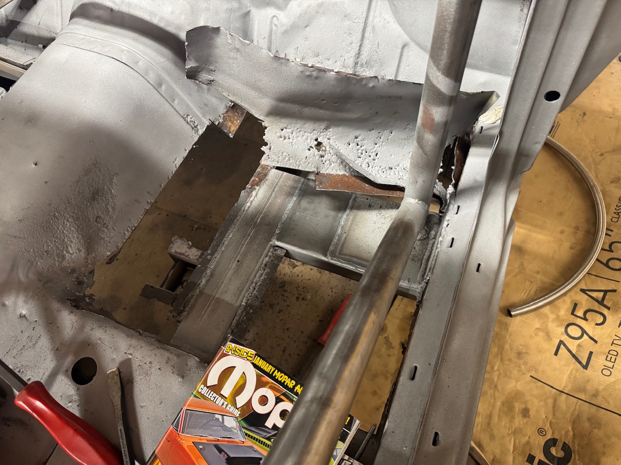

Finally have a little time to make an update. The text should roughly follow the pictures I’m going to post.

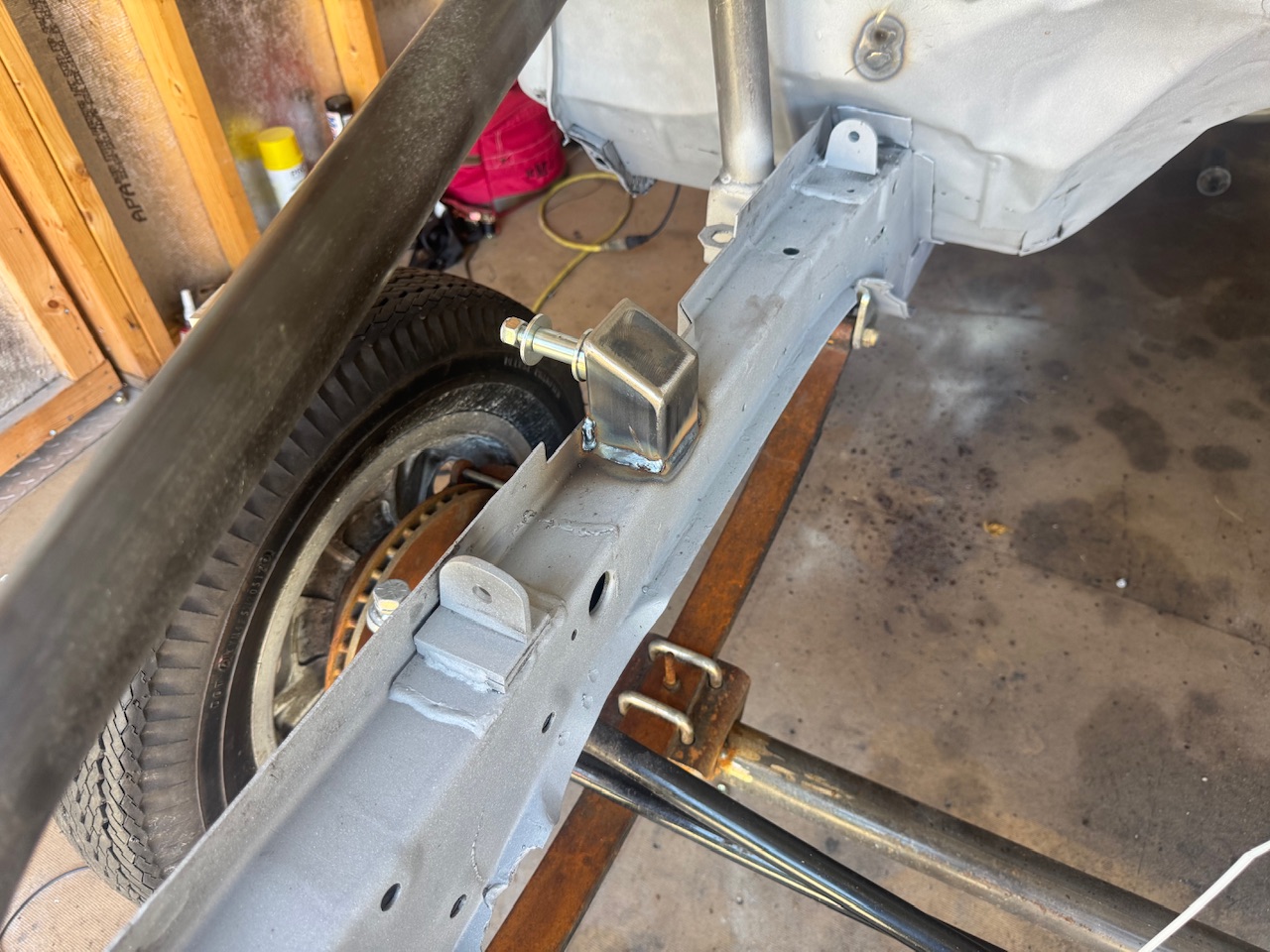

After looking all over the place I finally found where Marty hid the other shock mount I remember him playing with at one point. It was in the bottom of a toy bin. He hid it for later. I got it installed in my little mount and welded to the frame so both front upper shock mounts are complete.

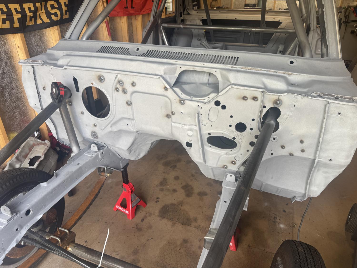

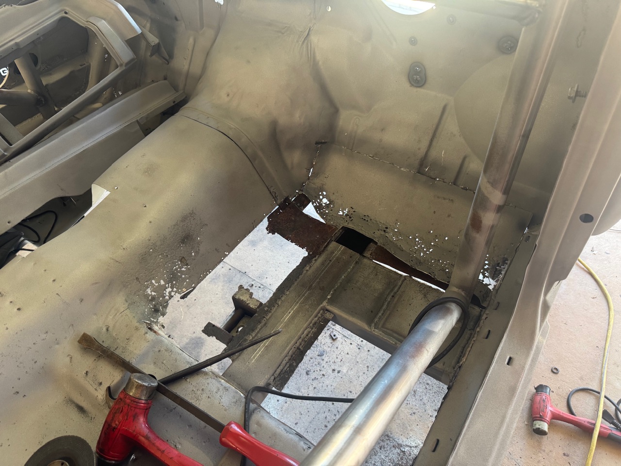

I’ve been working on removing the passenger side floor pan. I picked up a Javelin replacement. It’s almost the same except for near the hump. I’m still working on getting it cut out nicely so I can begin the process of getting the floor installed around the cage.

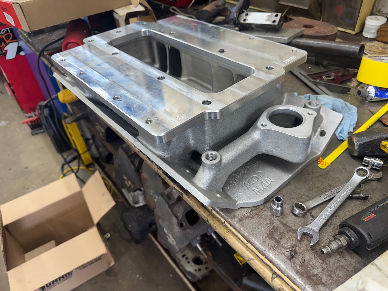

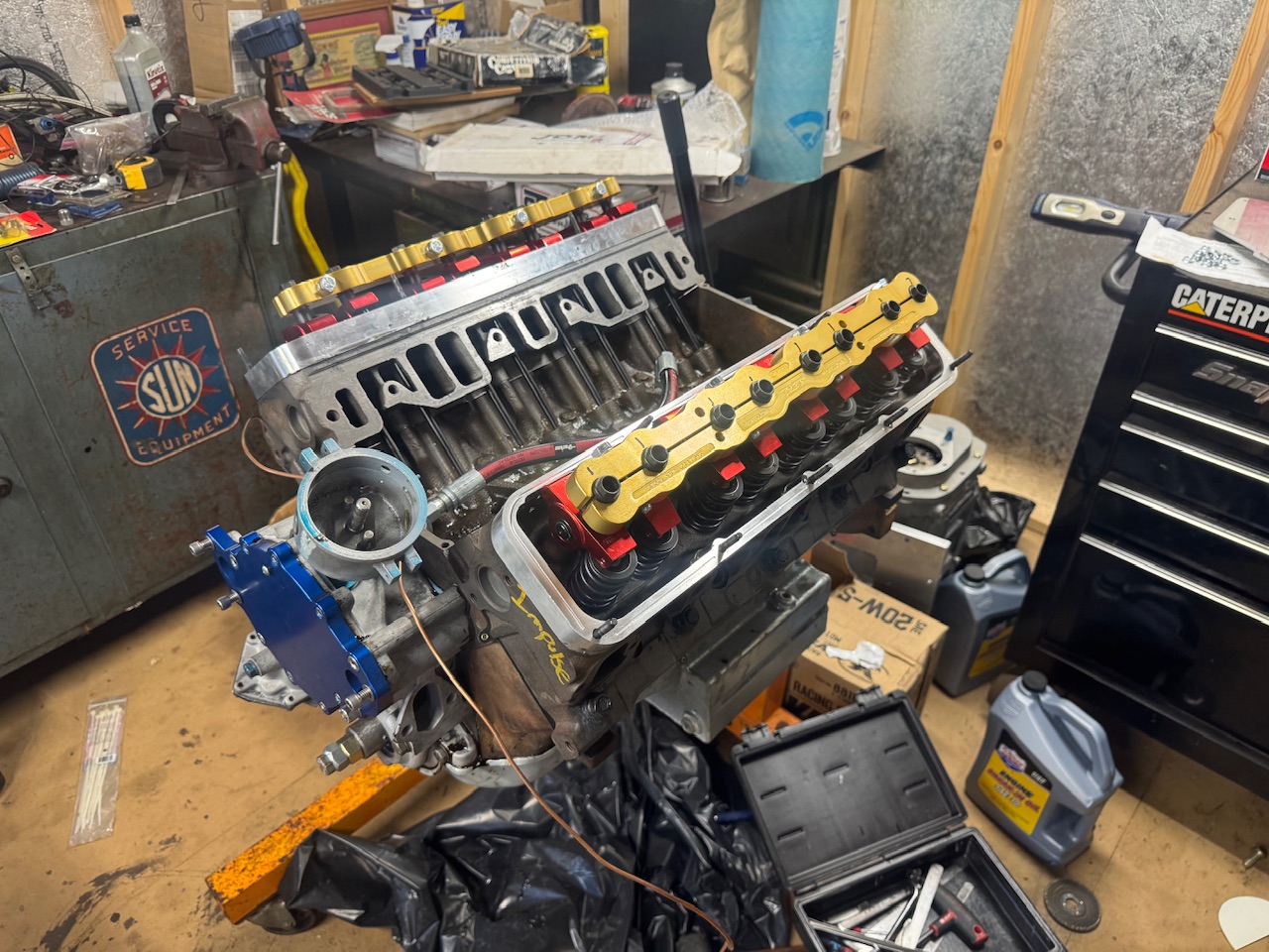

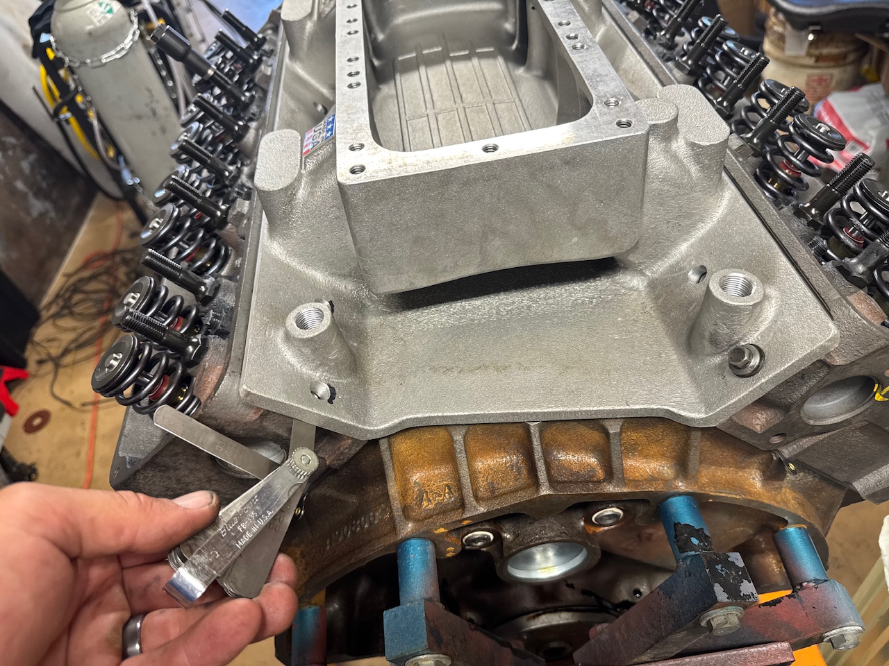

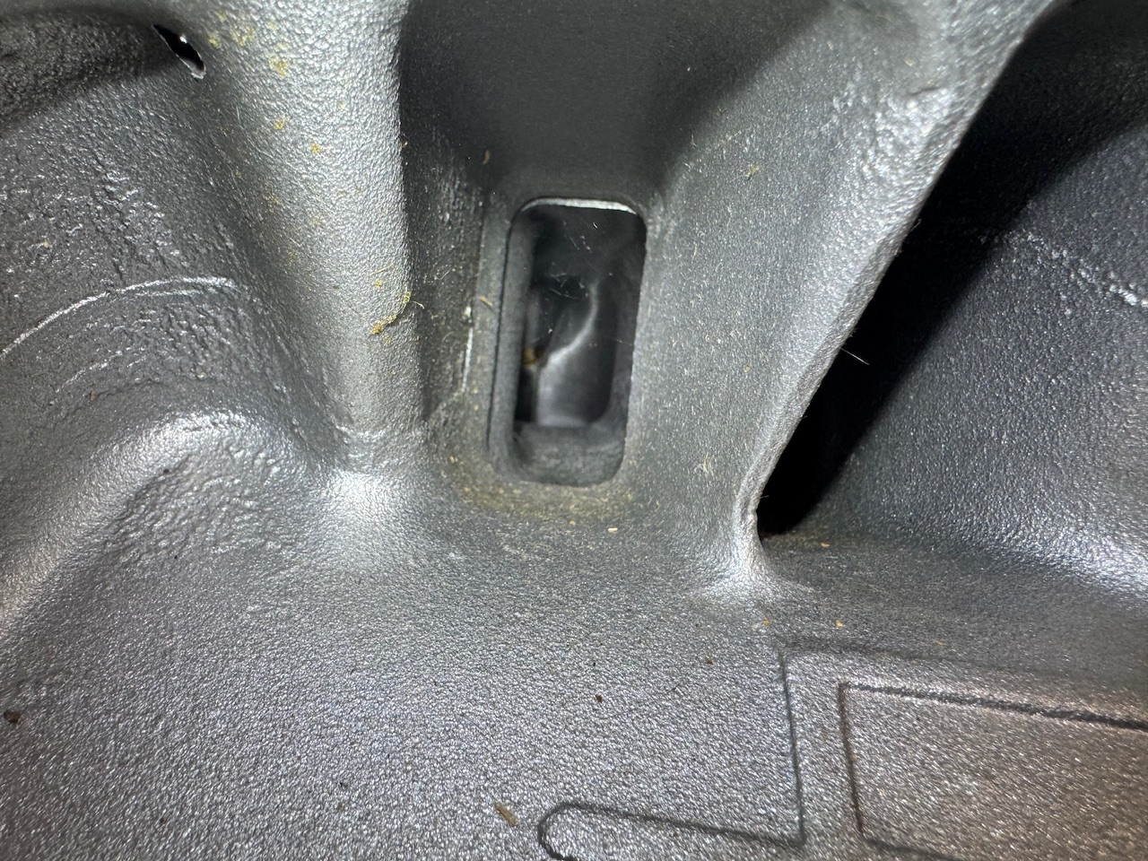

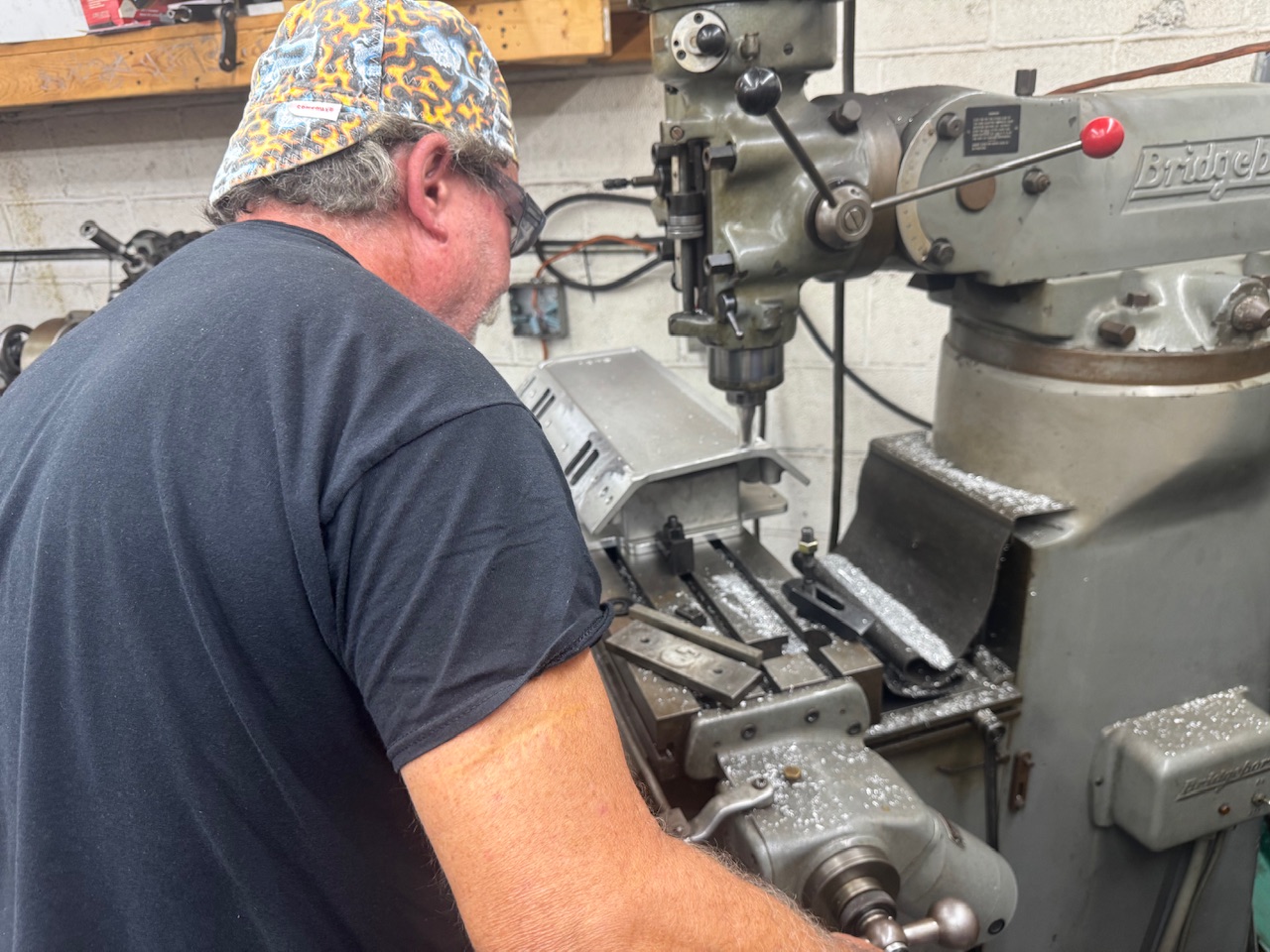

After Scott(my machinist) cut the upper edge of the intake to clear the valve cover rails I brought it home and tried it. It was much closer but now the china walls at each end of the block were hitting the intake first. So I took a ride back over there and he cut it while we bullshitted for a few minutes. He had .070 cut off the walls in about 5 minutes. Unfortunately it needs to be cut on the intake mounting pads so I brought it back to him today. I brought a NOS factory intake gasket to measure the thickness(.015) and he’s going to cut another .010 on both sides. Hopefully then it’ll sit nice and I can leave the intake on while I figure out all the pulleys and mounts in the winter.

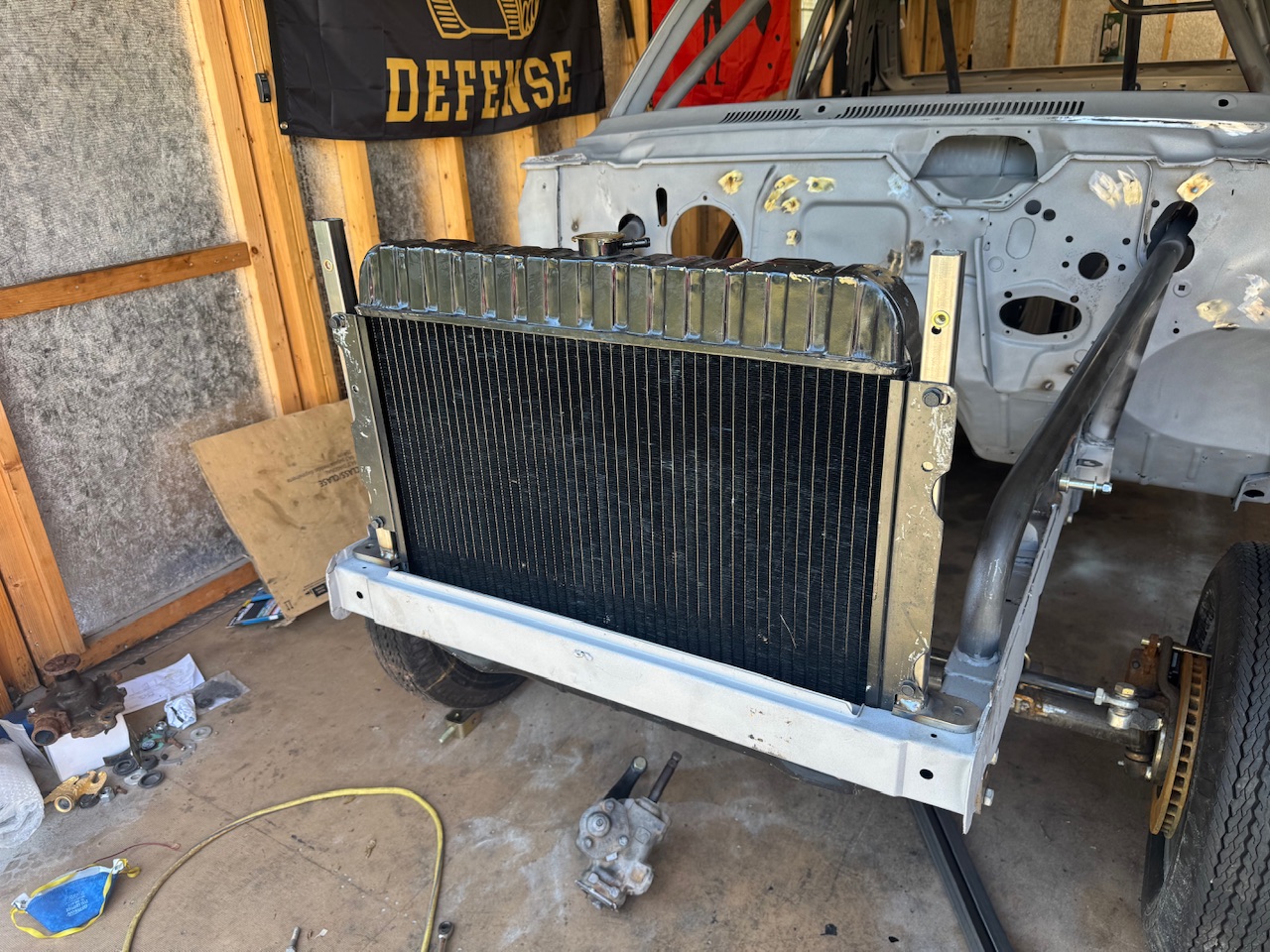

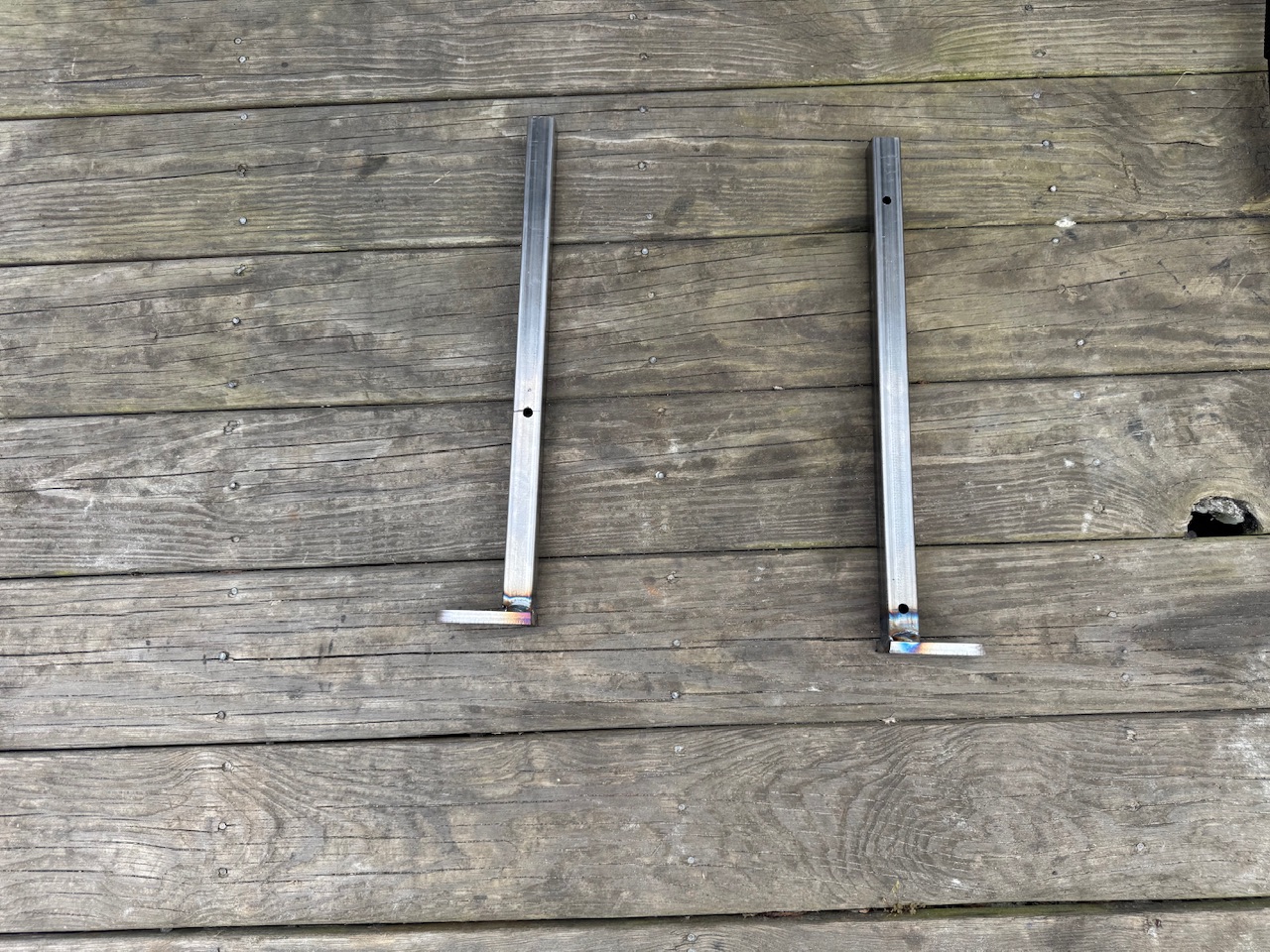

I started messing with mounting the 70 challenger BB radiator I had laying around. After some trial and error I came up with these little mounts that will hold the radiator, support the hood/hood pins, and can eventually also support the fiberglass fenders. I’m not a fabricator in any way, shape, or form. So feel free to make fun of them.

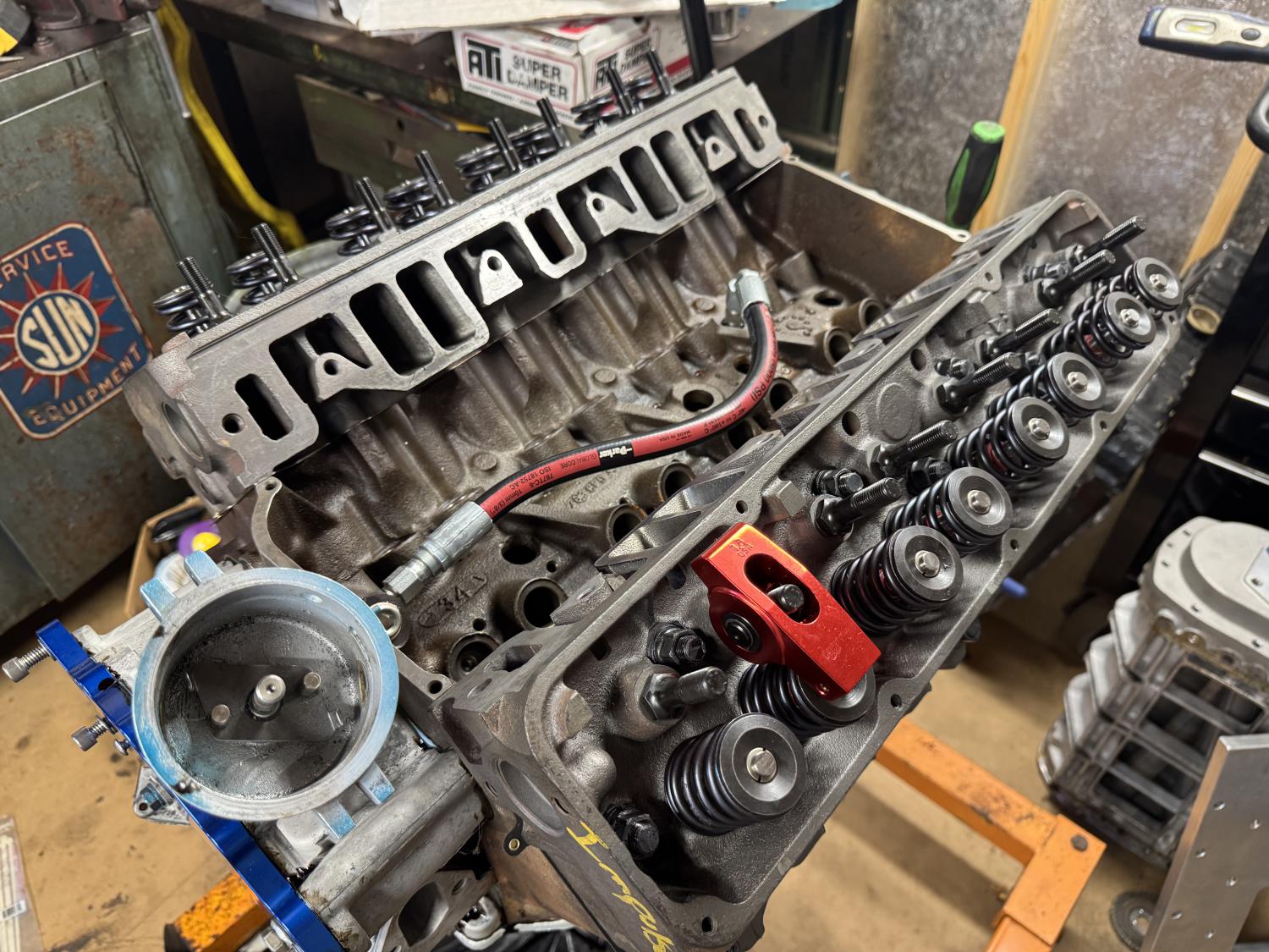

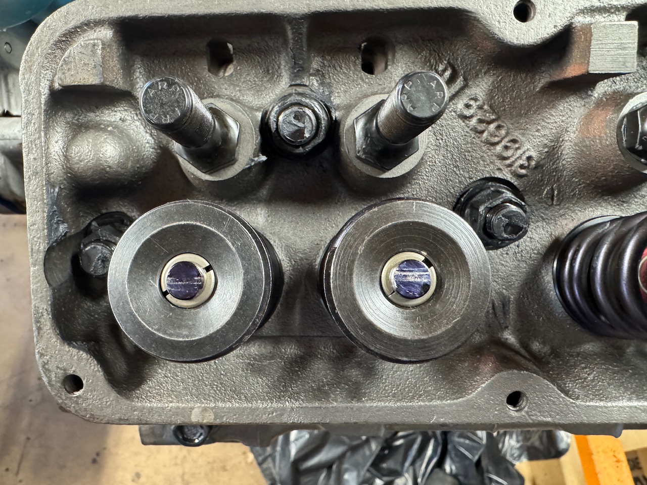

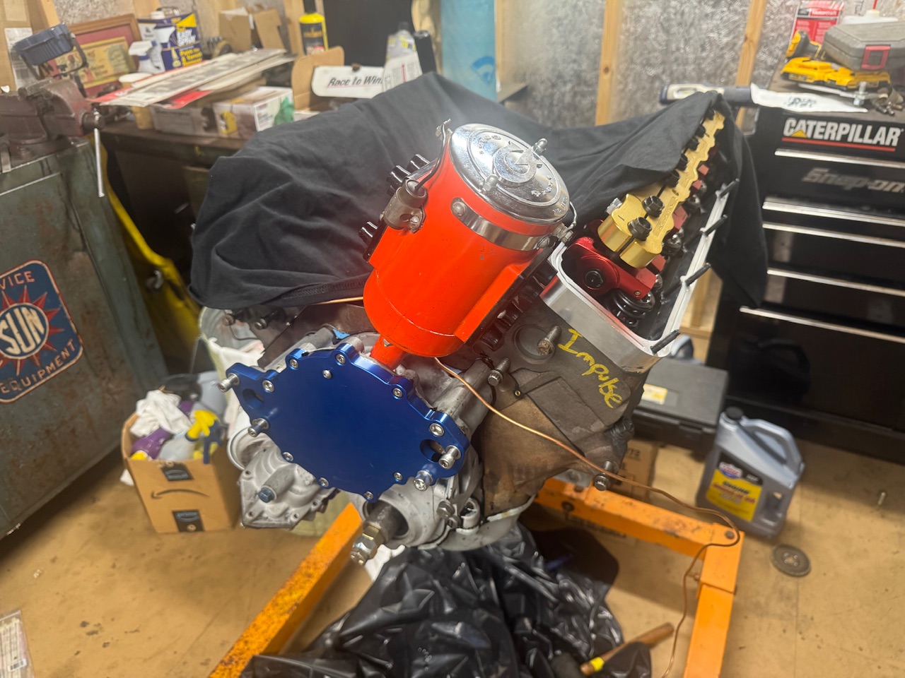

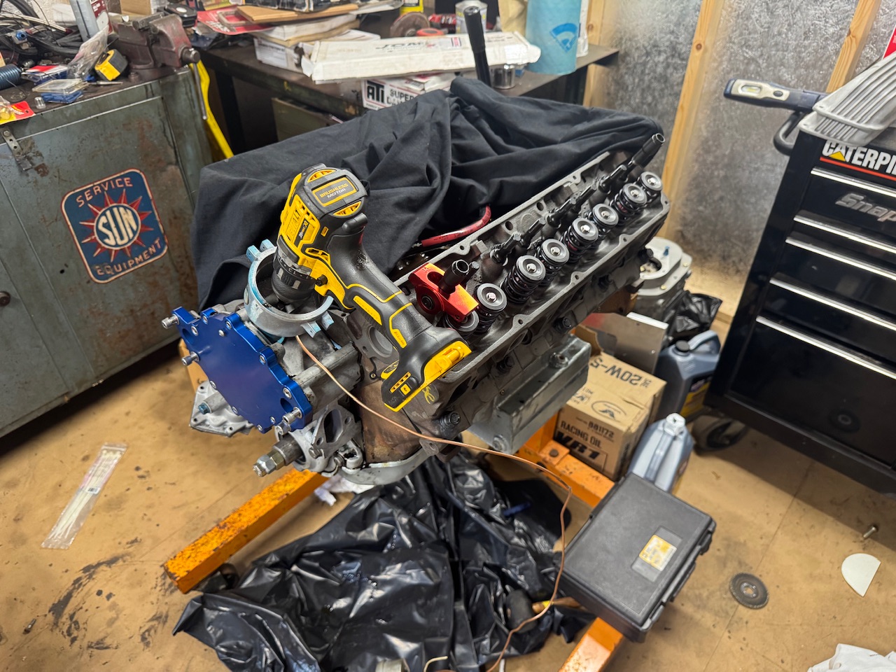

I measured for the pushrods today. On the valvestem on the left I ended up at 7.900. So I placed an order today from Competition Products for a set of valve covers. That wasn’t without its setbacks. I guess I haven’t turned the engine over since I bolted on the pan. And I hit a spot in the pan and it wouldn’t turn. Taking it apart I found a stud holding the Aviad pan windage tray was hitting the connecting rods. After first trying to trim it down to the nut. I ended up cutting off the whole stupid thing. I found a NOS oil pan gasket set in my basement so I used those 50 year old cork gaskets since I destroyed the first set removing the pan.

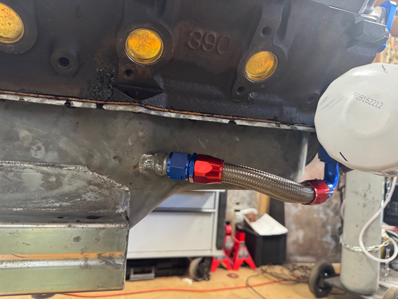

I also got around to finally making the small -12 feed line for the external oil feed to the block. And I had a local shop make a small -6 hose for the valley oil line. It’s a little too long but it’s not in the way of anything so it’ll ride.

Had a little time over the last few days to play with the car here and there.

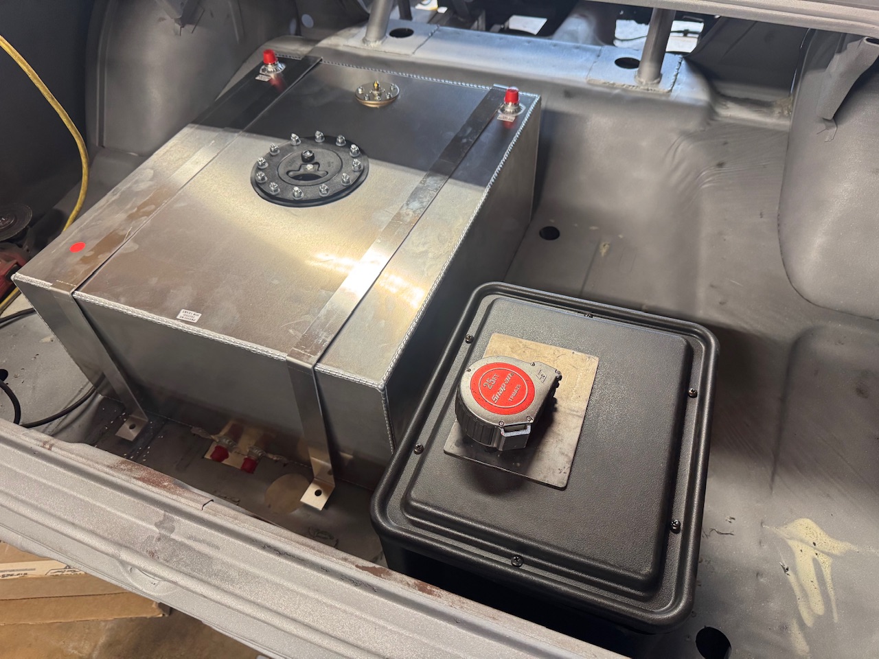

Got the fuel cell and battery box loosely installed in the trunk so I can eventually start planning out my shutoff, cables, and hoses.

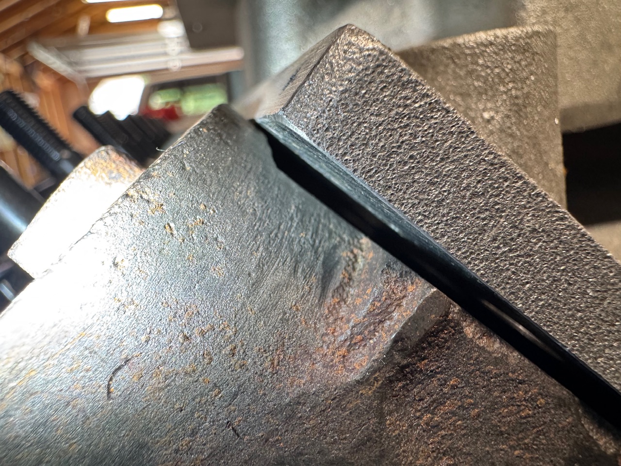

Ordere 1” valve cover spacers and got them installed. Once glued to the block I found that 1 rocker arm on each side ended up lightly touching the spacer. So I had to clean it with a file to fit. I caught most of the shavings and after I ran the oil pump primer for about 15 minutes one day I’ll swap filters out hoping that caught most of whatever was left before I start it. I ran the primer for about 5 minutes today while turning the engine to get oil up all the pushrods and rocker arms.
Of course after that I found the valve covers also hit the rocker arms. But the valve covers require other machining too. So once I have all of the parts I need they’ll go to Scott so he can do everything at once.
At the end of the day I test fit the intake back on. Scott cut .025 off, adding back .015 for the steel shim gasket I’ll be using. So a true loss of .010. It’s going to be close but I should be able to get all the bolts in. And then I wanted to see if my Grant Flamethrower distributor would clear the blower/ drive. Which I believe it will.

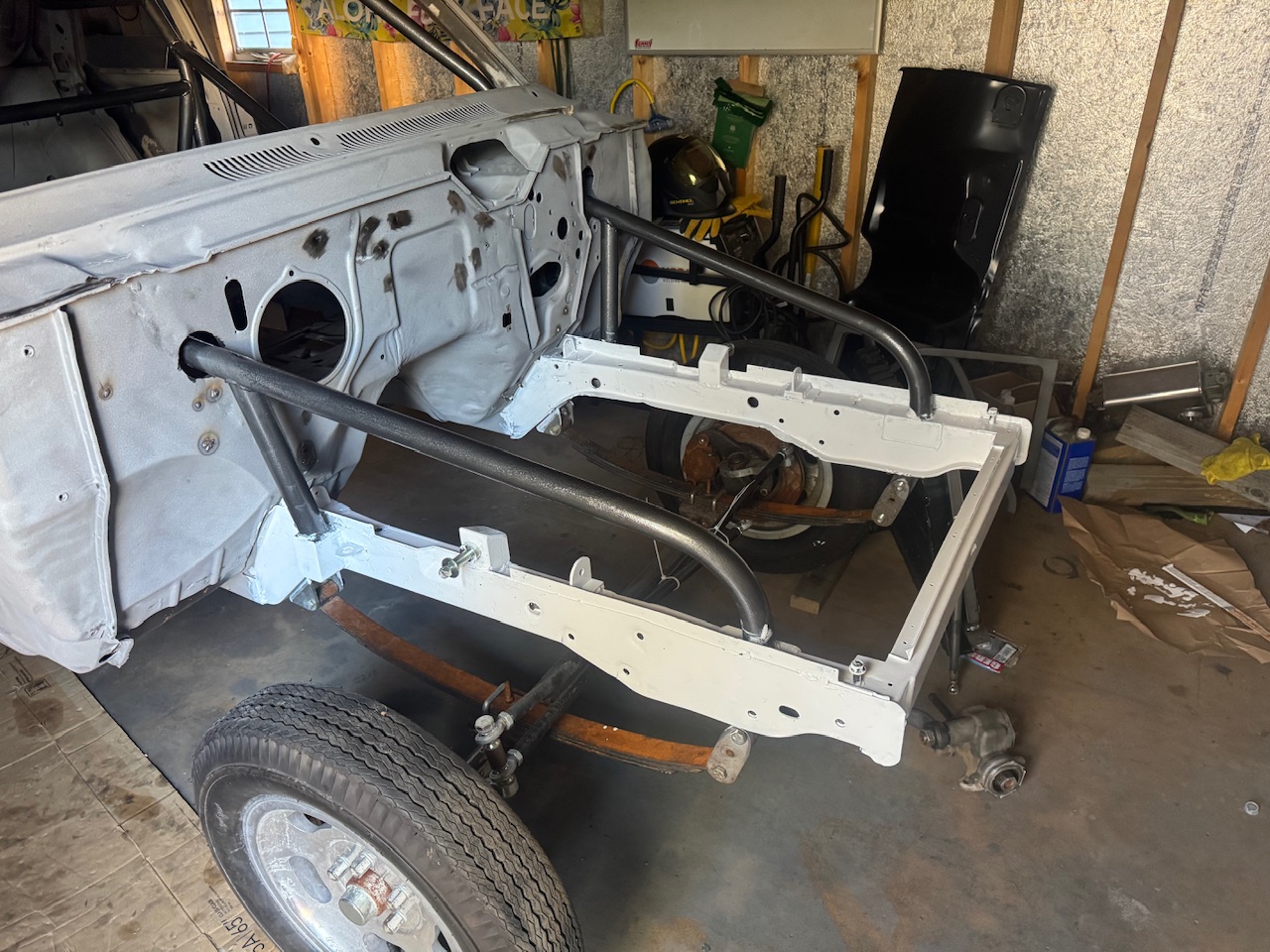

Street Freak update:

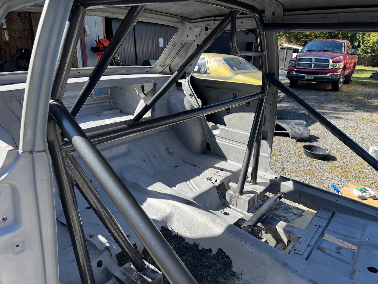

Took the day off of work to force myself to work on the car some. It’s been sitting and I want to start getting stuff painted before the winter. I’d like to get the top of the car in primer, but I’ll see if that happens.

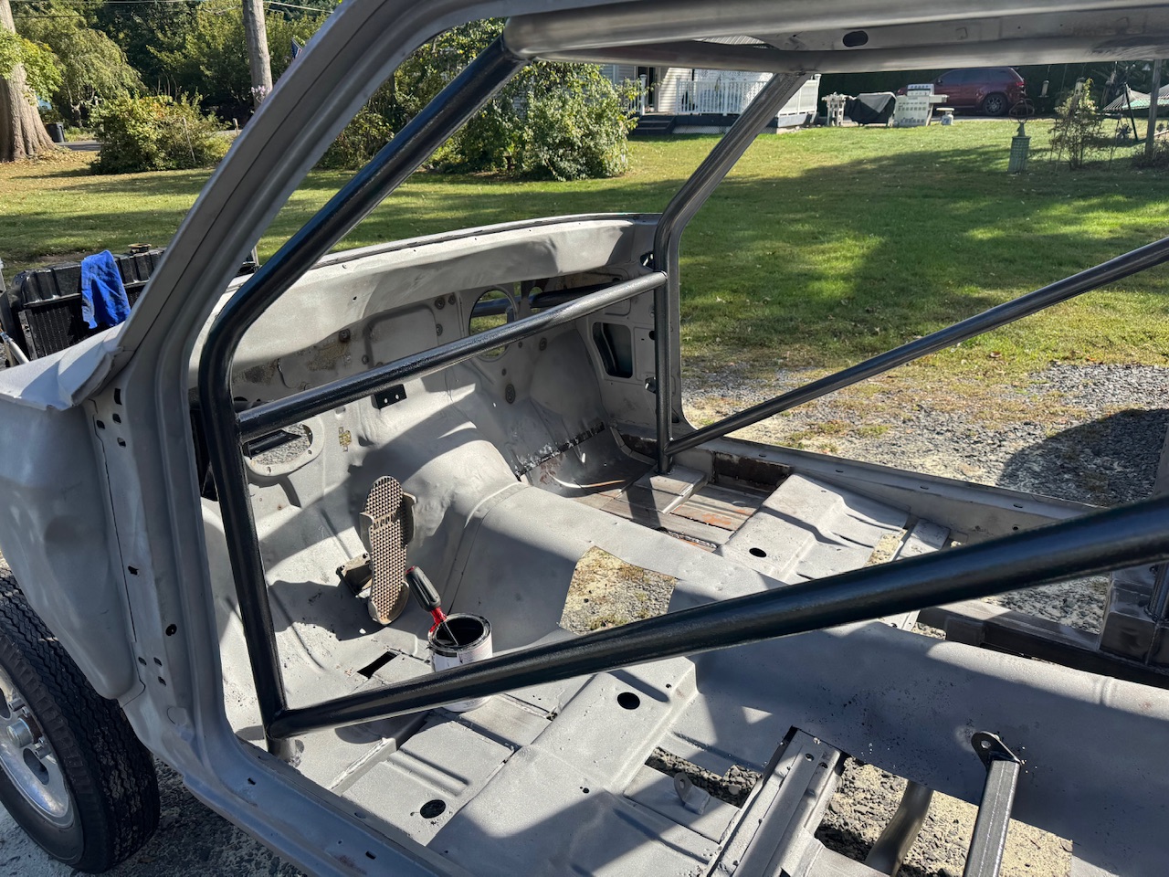

Otherwise today I painted to roll cage using Rustoleum hammer black. A couple of posts on YellowBullet talked about brushing it on so I figured I’d give it a shot. I’m thrilled with how it came out. First thing this morning I got the car pushed outside and spent half an hour blowing the car off, sanding the cage, and wiping it down with prep wipes. Took about 2 hours to get the whole cage done and like I said, I’m very happy with it.

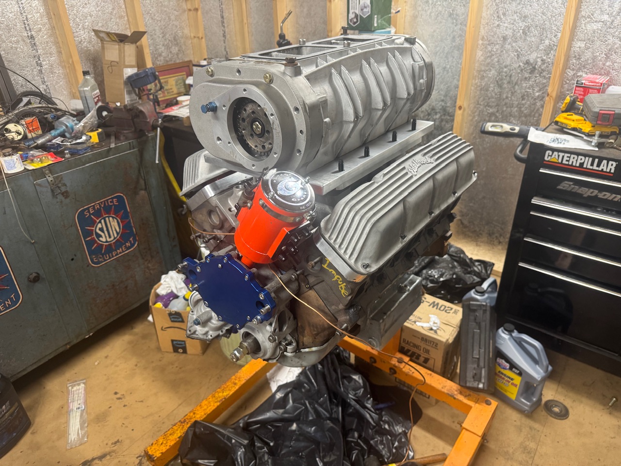

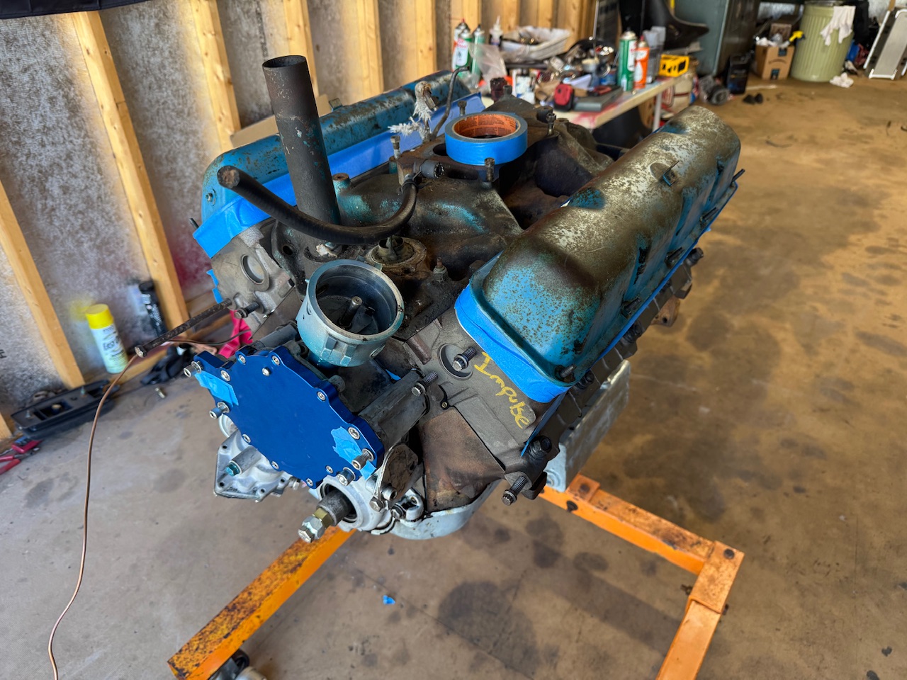

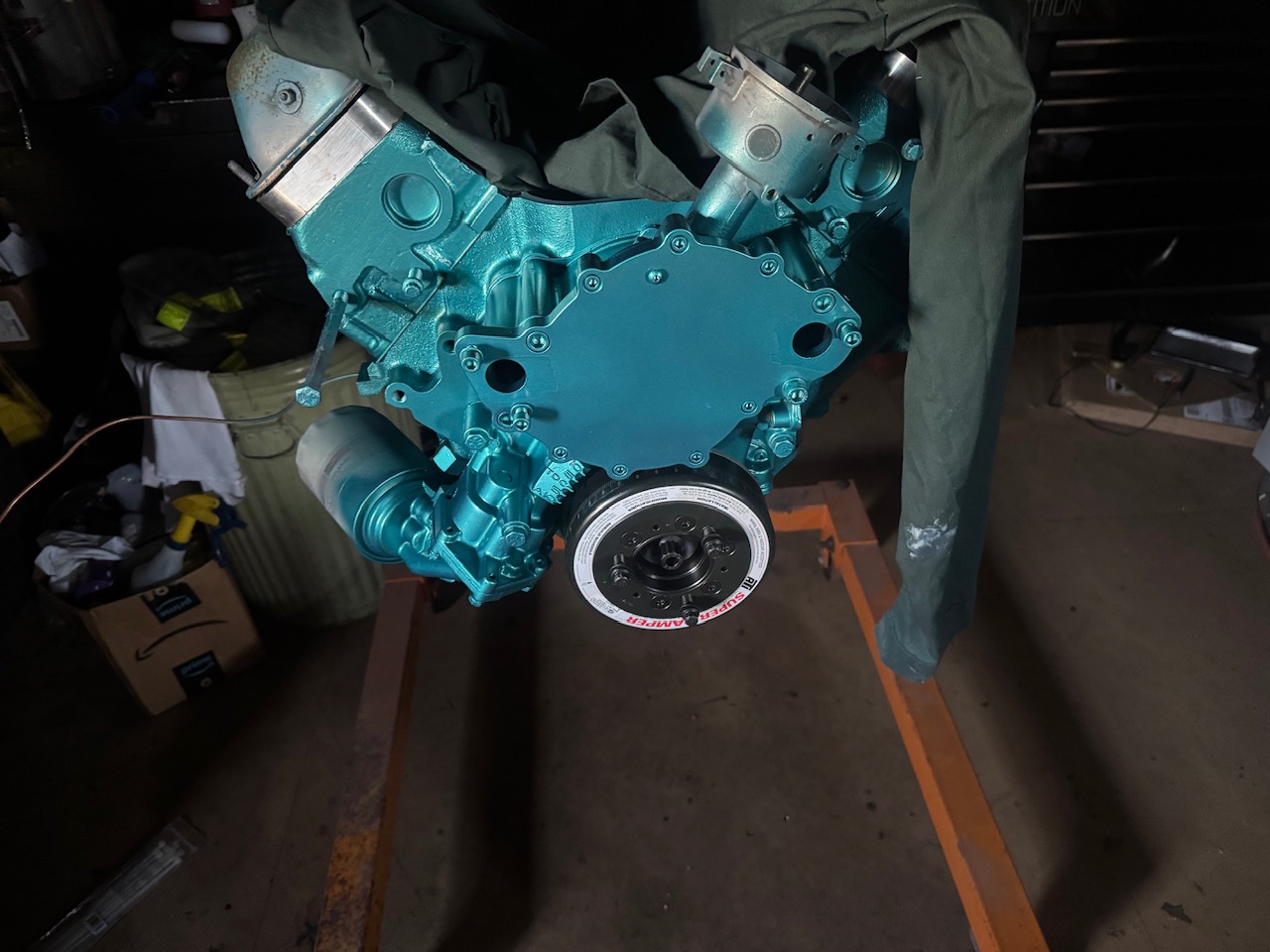

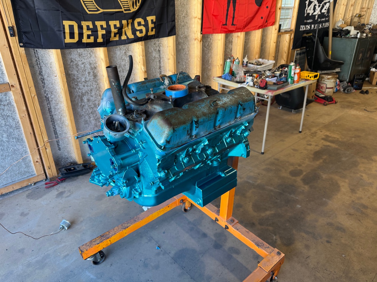

Once that was drying I pulled the engine forward and got that prepped and primered. After waiting about half an hour I painted that engine in AMC metallic blue. Personally I think it’s far and away the best looking engine color ever used by any manufacturer.
My last project of the day was painting the front frame rails white. I’m planning to paint the whole underside of the car this way but wanted to test somewhere first. It’ll sit and harden overnight and I’ll see how it looks in the morning.
I also spent a few minutes once the engine was done and got the damper torqued into place using an arp balancer bolt.
With any luck I’d like to get the engine back in the car so over the winter I can piece together all of the drives for the blower, fuel pump, and alternator.
