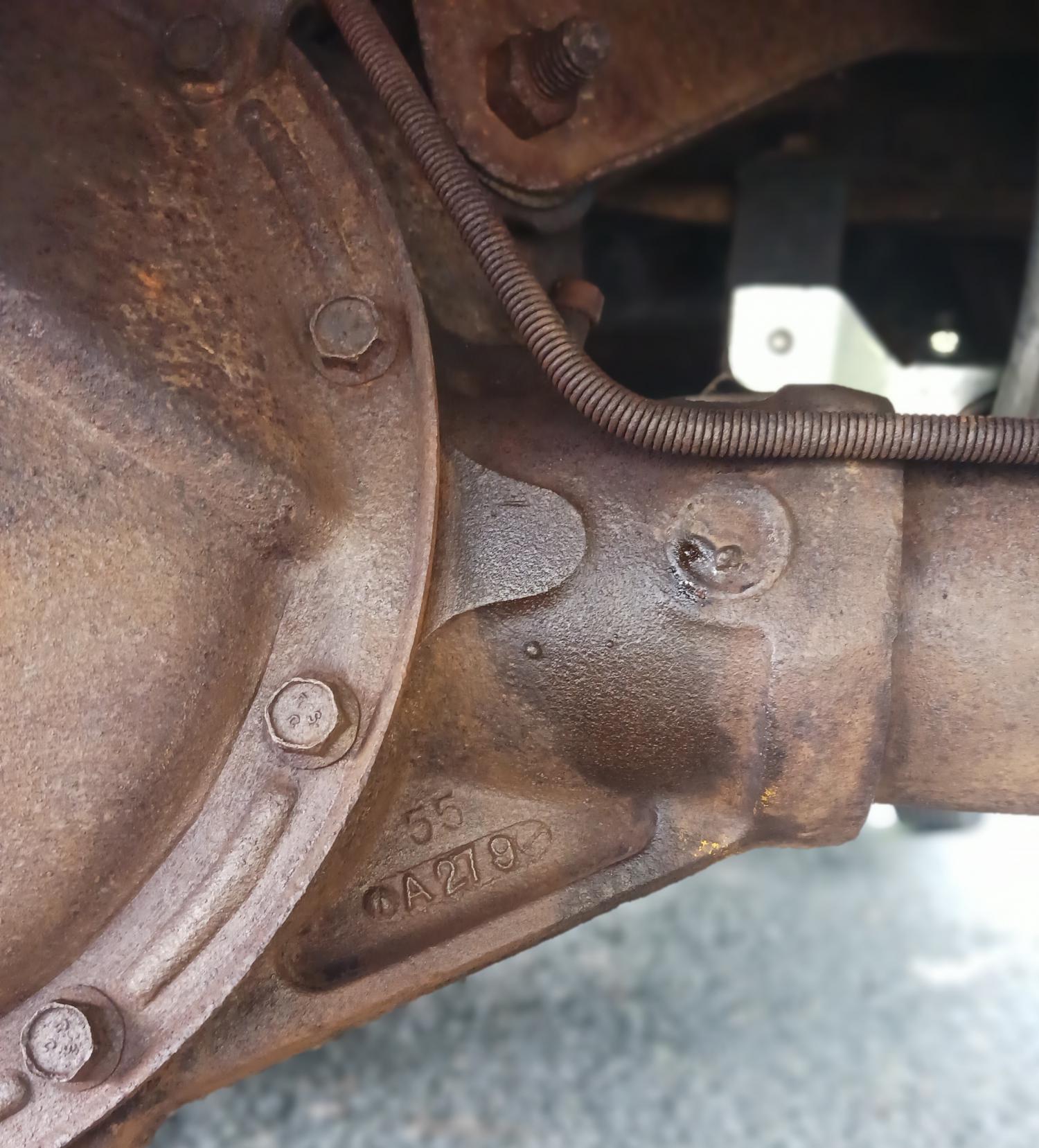

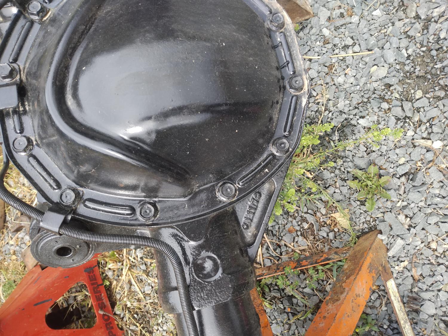

Probably not the right person to answer Camaro questions but can speak for Chevelle covers.
68- 69 Chevelle 12 bolt covers do not have any notches.
The bolts are different on ours.
68's all have RBW and the 69 has RSC.
Top pic is 68
Bottom pic is 69.
Dates in different place and different casting numbers but covers same.
Always thought 68- 69 Chevelle, Camaro and Nova took the same cover.
Have a 68 Impala 12 bolt and it has a notched cover.
Repop covers are not an EXACT match.
Easy to find real ones
Good Luck

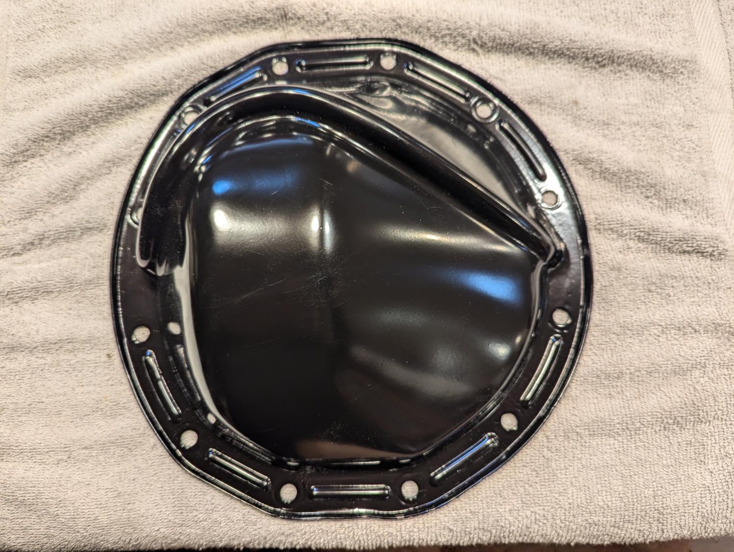

I have this one................but not sure what it was born on...........
68- 69 Chevelle at least.
Very likely more apps than them.
Looks like a nice un- pitted one to boot.
