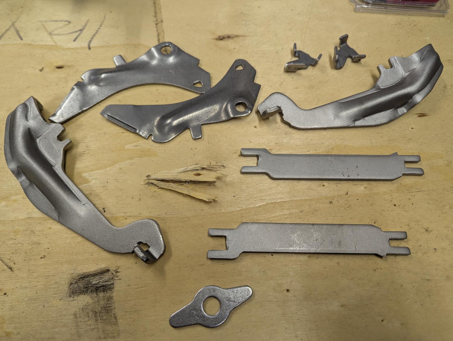

SEYMOUR Stainless Blast Aerosol to replicate "Bare Steel"
OR Everbrite "PermaClear" over actual shot blasted steel (NOT Glass Beaded)
( I have not tested the PermaClear method for Rust hold out....
but did just coat some of the brake drum natural steel parts
with PermaClear)
These below parts were glassbeaded and then tumbled in my ceramic media /
shaker machine
