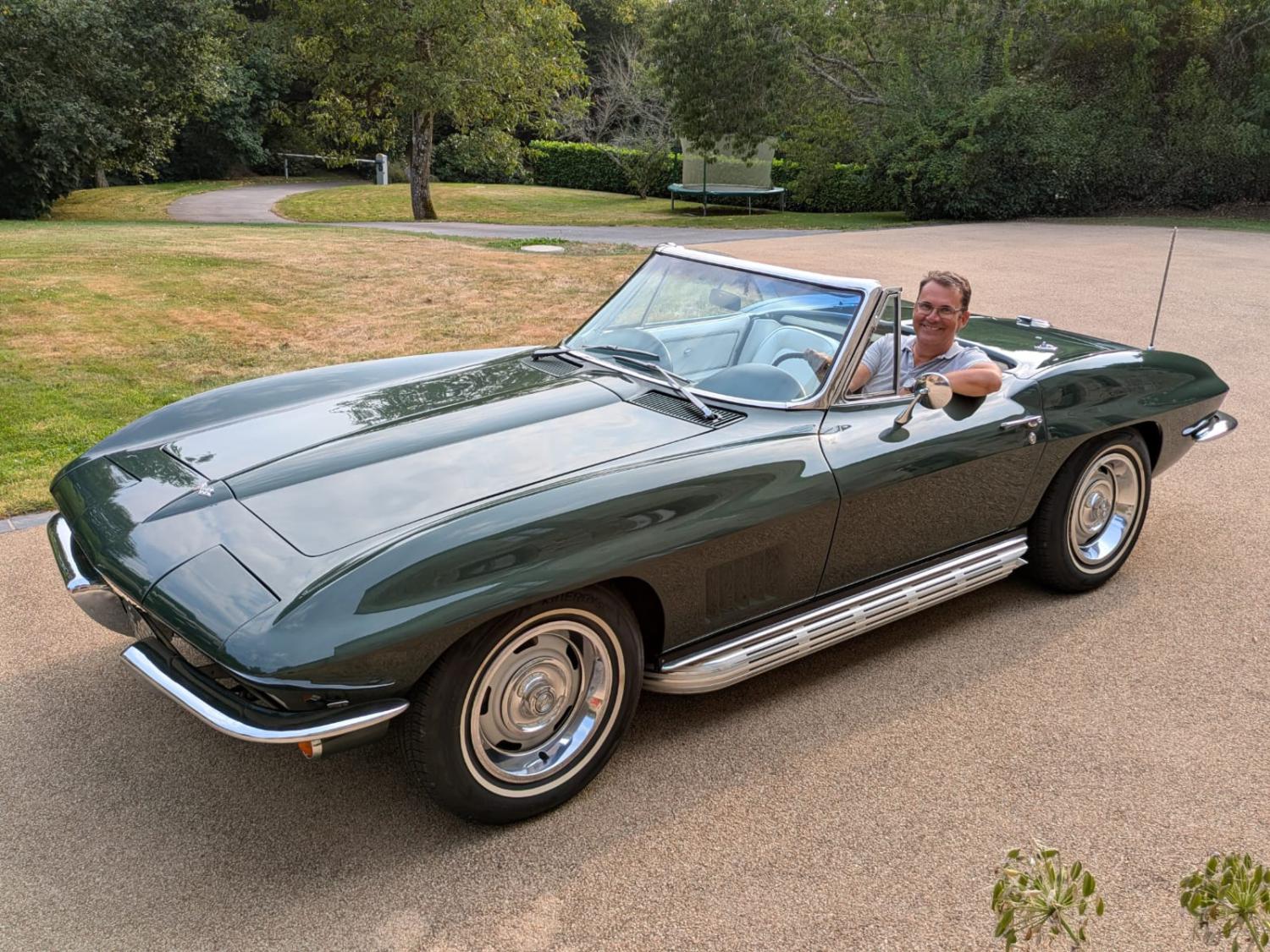

While I patiently wait for the Nova to arrive, I'm staying busy in the shop with a couple of other irons in the fire.
One being this 67 roadster I just bought. Nice all born with numbers car, Goodwood Green with a black and white interior. M20 wide ratio 4 speed, 3.36 posi diff. 2 tops, AM/FM, P/S, P/B and telescopic wheel. The car originally came from West Virginia (as documented by it's POP). The car is reported to be a legit 20k mile car. The car retains it's original riveted ball joints and factory installed idler arm. It still retains all 5 original DC wheels.
There are some items I'll leave as is, others I'll get closer to stock. This is as I picked the car up......
My goal with this car is to offer up a REALLY nice driver that has good colors, good numbers, and good value. This should make the new owner proud at a local car show, or just cruising around. The sidepipes were reportedly added by the original owner (who was the son of the Chevrolet dealer). More on that later.
Here are some of the numbers on the car. I'm assuming the intake and carb were purchased during the restoration, as the dates are a bigger spread than normally found on something like a base motor car.
More to come........
