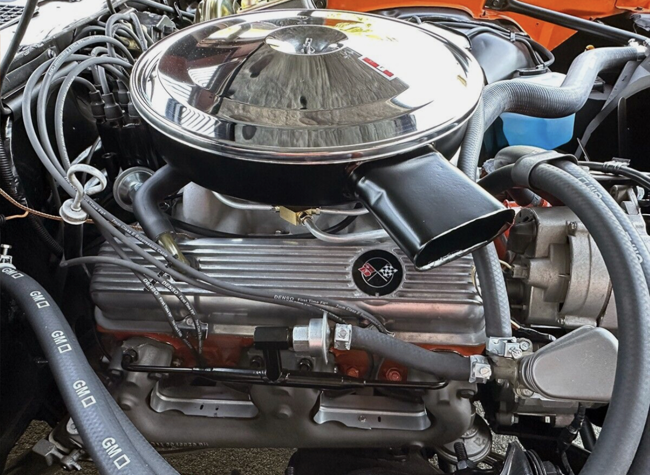

Besides non original RS and wrong stripes, and a few other small things,
what do you see wrong with this engine compartment ??
Can anyone explain? Hint.. M-21 car.

Trans dipstick.

Never seen a TV cable on a muncie.

Look who's selling it.....that speaks volumes.

----If he has the NCRS paperwork, why not show it? Very suspicious! A ten year old child could get the stripes better than that....Bill S

That dipstick would be handy for checking the gear oil level in the Muncie! What are these people thinking, that no one would notice....
