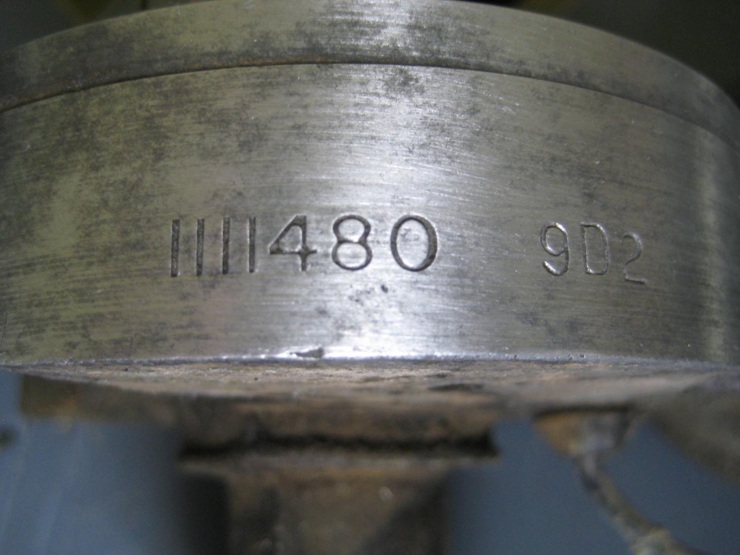

Soon, I will be listing a project '69 Z/28 for sale and in preparation I made a detailed list with photos of the the important stamped numbers, casting numbers and casting dates. I would like to get opinions on this stamping to make sure it is original and not a re-stamp. I have no reason to doubt its authenticity but your opinions would be appreciated.

Compares very well to my originals.

Thanks Lynn!
