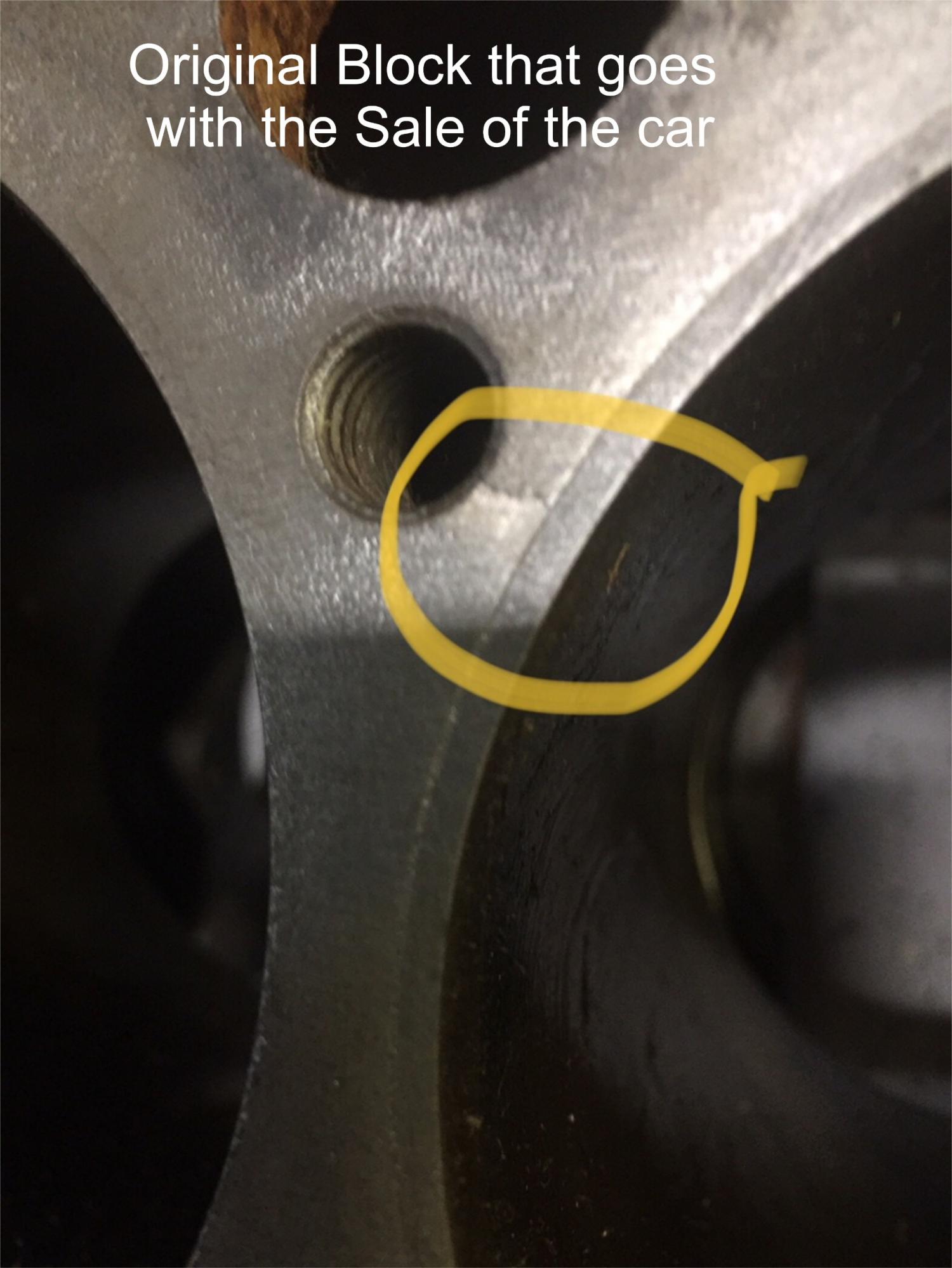

I am looking at buying a 68 Z and the original block that comes with the car is cracked, I was told years ago it could not be repaired, but now with today's technology it could be. If it can be repaired, what would be the cost?

Sleeve and a helicoil/thread insert should take care of it.

Yes, it can be repaired. A sleeve will take care of the cylinder. Cast iron crack repair plugs should take care of the deck. A Jergens thread insert will fix the hole. Talk to a good machine shop and get their opinion because they will be the ones to do the work.
Indy Cylinder Heads had an oven that they used to weld cylinder heads. I don't know if they can do blocks too, but you might ask.

They do it all the time t our local machine shop…..they can “pin it” without any issues. It may have to be sleeved as others have mentioned.

The go to guys for cast iron repair is Lock and Stitch located in Turlock CA
I’m having a block repaired there currently. I’ll let you know how it comes out.
Not cheap!
