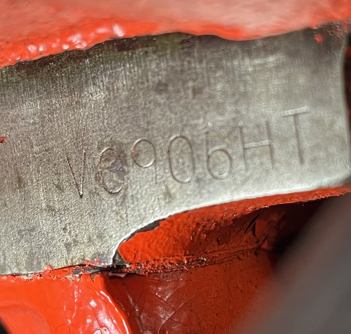

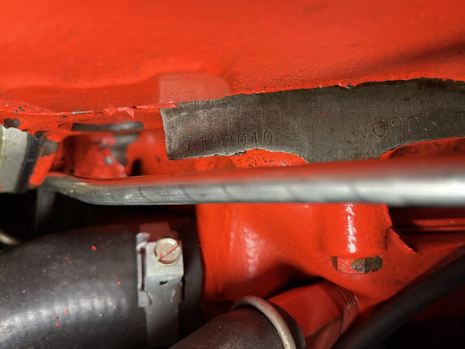

Hi all, Wanted to get opinions on the pad stamping on this L79 car.TIA,Rob.

I don’t think so.

Agree with TG!

Agree. NG

Agree with TG, MG and JM...NFG!

Definite stamper.

Wow, that's a whole lotta concurrence!

Not original but good example of what ‘Numbers Matching’ actually is.

Not typical factory production

Whoever put those broach marks on there (likely with a belt sander) purposely tilted the sander to the rear of the block to create that slight slope on the pad. Fairly common practice to tip downstream buyers it is a stamper.
