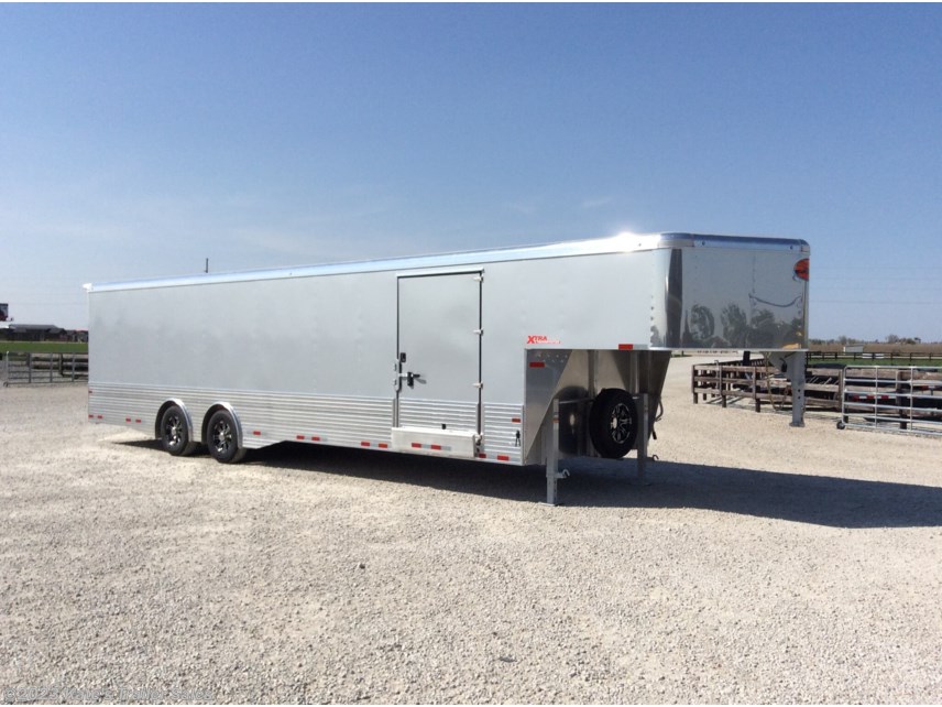

Something like this Sundowner Xtra is what I have been contemplating. In white of course, so it matches my truck.I like the idea of a gooseneck, as the weight is distributed in a much better place in the truck. As I understand it, it is much more stable in a crosswind (or when semi's pass you). Admittedly, I have not driven a gooseneck myself.
With 28-30ft on the floor, I can pull a car forward far enough to get out of it, and just roll it back to tie it down. I originally was thinking about a side door, but fear it takes too much structure out of the trailer. As we know, trailers take a POUNDING.
As I see it, the Sundowner has thicker aluminum than the ATC (both in the walls and roof). I also like how far the front nose of the Sundowner is V'd. It would give me more room between the trailer nose and the cab of the truck when turning.
So, I'll take the opportunity to ask this. Do any of you have experience with a Sundowner? Might there be a suggestion I should be contemplating? I am incorrect in any of my thoughts? We know these things are not cheap, and I hate doing things twice (unless I am buying back a killer car)

With the extra strength of the extruded sides, I wouldn't be afraid to add an escape door. I'm sure the design has been engineered to account for the opening and those sides almost make the trailer a unibody with the frame. Looks like a heck of a trailer, but the website seems to be lacking a lot of detail, especially available options. The first option I would ask about is self leveling air ride. That alone will reduce the stress on the rest of the trailer, and your cargo, immensely. It could include an onboard, electric, compressor with a dump valve to lower the floor for loading/unloading.
The low-pro is interesting too, but it doesn't seem to include the car hauler. Too bad, as it would help with wind resistance and sway.
Yes, I believe you will like the increased stability of a 5th wheel attachment over the bumper pull.
