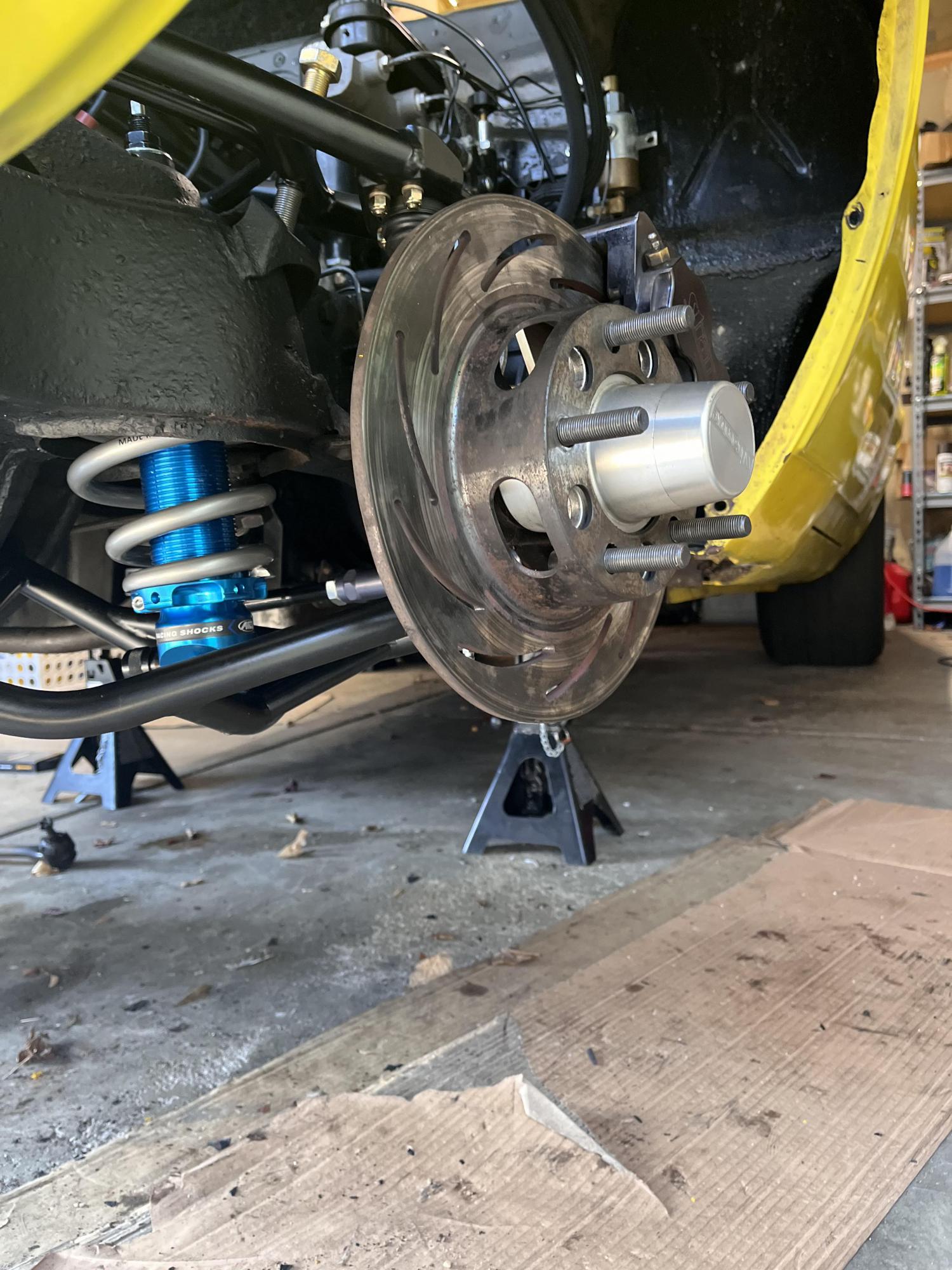

I'm planning set up mine like my friend Aarons, check out the spacers below the tie rods:

Can't comment on the TRZ kit but I will verbalize an observation of mine ... your rear coil overs look awfully close together compared to where the tires sit. Spacing them out could only benefit you and, if you don't already have one, a rear sway bar might be a nice addition.

Yeah those being close together probably is not helping. I'm monitoring whether I need to add an ARB, playing it by ear.
I might try to move the car back to leafs next year, will investigate my options.
