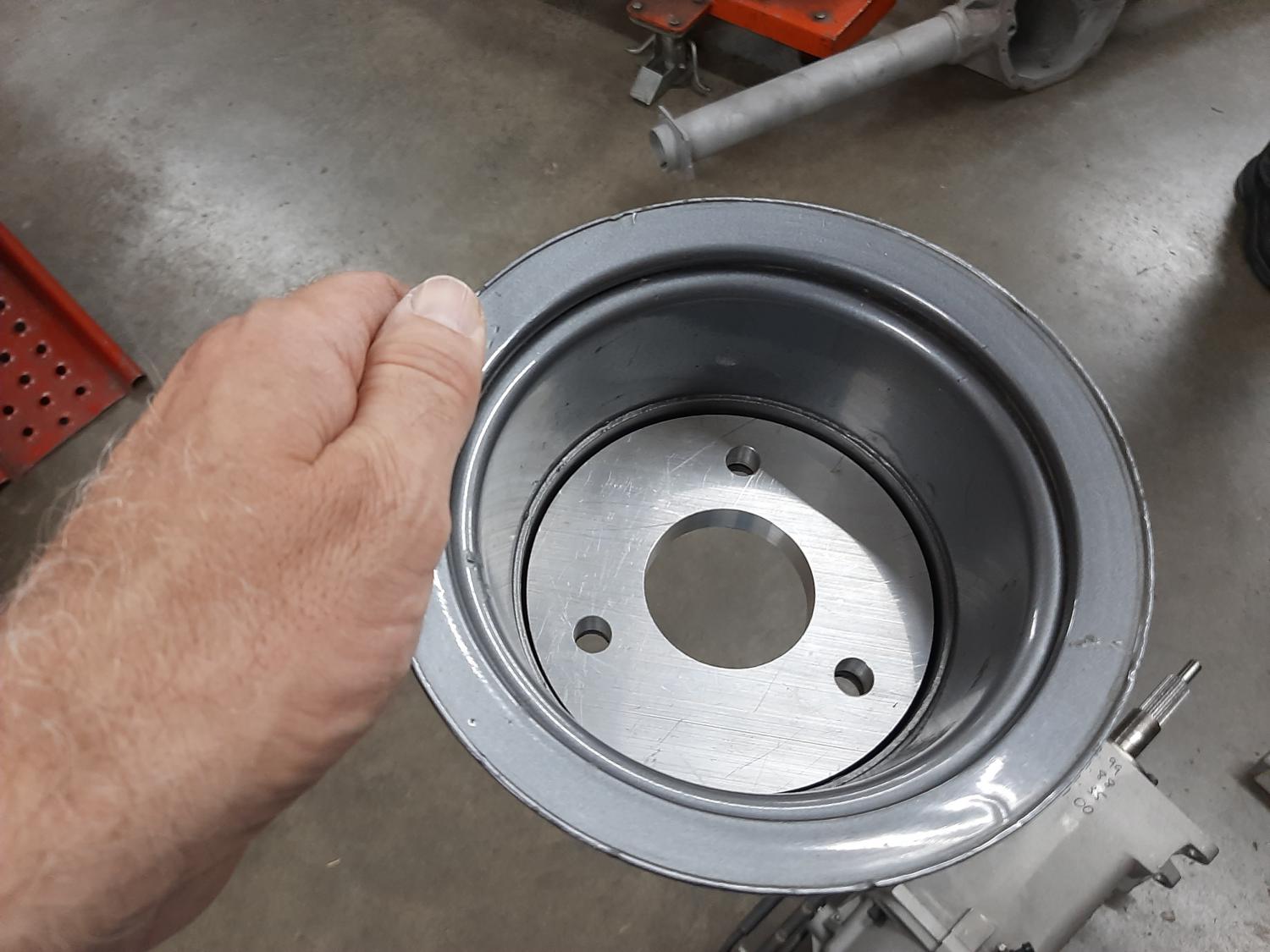

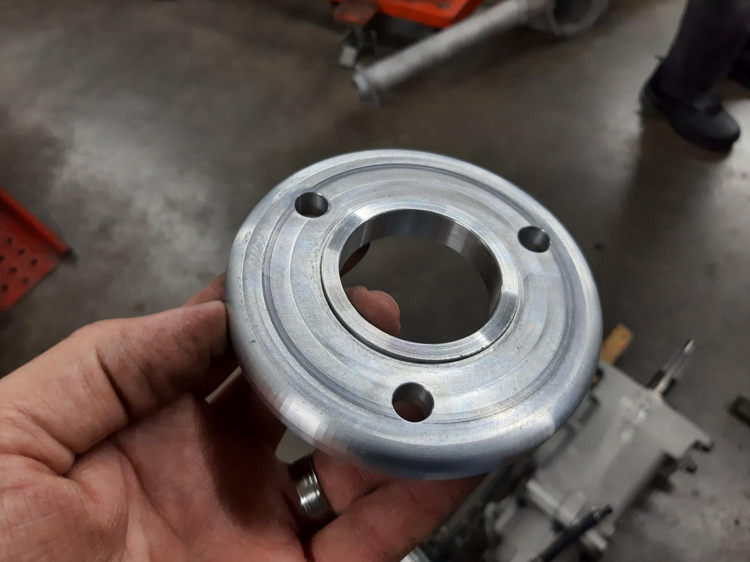

What about putting a reinforcement plate inside the pulley? Would that prevent it from cracking? I'm using a standard groove original GM pulley on mine and shifting gears at 7200 RPM. Now I'm wondering if mine needs to be reinforced.
Freddie, aren't your pulleys formed steel ? The pulley for the swp is cast. I'm surprised you don't have belts flying off the standard pulley's. Maybe I'm OK with that too. I will definitely change out the alternator pulley for the deep one, as that seems to be the source of that belt coming off.
