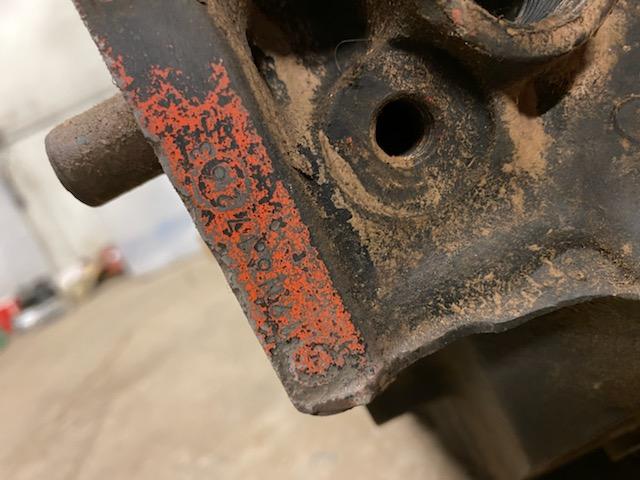

Arrow Found block 69 396/375
Another person has this and wants to find the rightful owner.
1969 Camaro L78 Casting#3955272 396/375 SHP MT 4 bolt mains with engine code T031IJH and vin# is stamped and legit. Block is PA aera
"Block was removed in 1969 and replaced under warranty. Block was stored at machine shop until now"

Engine assembly date seems to be missing a number. Can you post Vin?

Some pictures of the block.

124379n617263

T0311 is the date assembled.March 11th.

N617263, not known.

So is the VIN on the block for car # 124379N617623 or 12437N617263? Just trying to learn here. Bill

The 9 is the model year indicator, 1969

124379N617263 is the full VIN

No, No..... the VIN as stamped on the block is N617263, NOT N617623.
