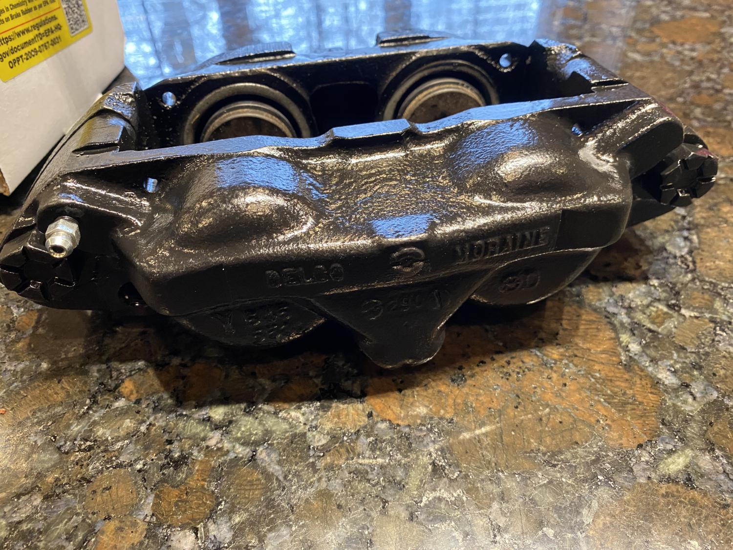

Who rebuilds/restores brake calipers? I need the 4 piston calipers for my Beaumont rebuilt. I'm having a hard time just finding rebuild kits for the 4 piston ones.
Thank you, James

Thanks for the responses. The NAPA here doesn't offer a rebuild service for these. I checked with White Post and Goldline Brakes. Also called Muskegon but no one answered the phone. Has anyone heard of or used Phoenix Caliper out of Chicago? Prices from each of these companies varied a lot. Goldline was $1400 for a set. White Post was $640. Phoenix was almost too cheap at $290 with a 2 day turnaround.
Since no one answered at Muskegon I called Lonestar hoping that they weren't wholesale only. They are not. They are $480 for the set with a one week turnaround. I think I will use Lonestar.
I had checked with all of the local parts stores and Chevelle parts suppliers. None of them can get rebuild kits for these 4 piston calipers.
