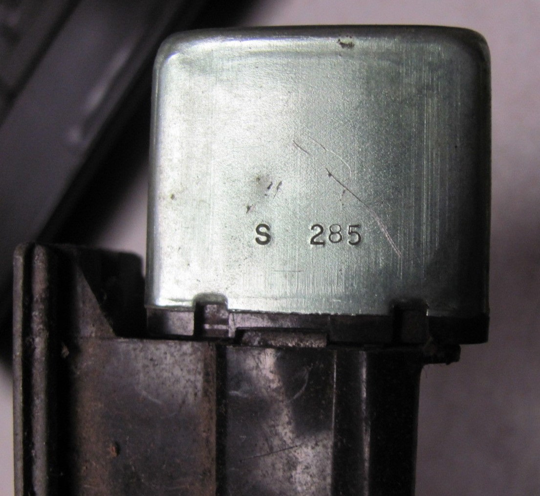

Good Morning Guys,
Here are some shots of Signal-Stat 170 flashers. They were used on Chevrolet hazard warning flasher units during the mid to late 1960s. My question to the experts here is how to read their stamped date codes? Here's two examples of S 285 and S 056.
If you know for sure please share it with us here. These things have gotten very expensive and I'd like to pre-date my car's build date with one of these originals. My '66 Corvette calls for the 170 flasher.
Thanks for any help,
Mike
Attachments - The Supercar Registry Signal-Stat 170 Flasher (D).jpg Signal-Stat 170 Flasher (C).jpg Signal-Stat 170 Flasher (B).JPG Signal-Stat 170 Flasher (A).jpg

I believe they are 28th week 1965 and 05 week 1966

See if this helps:
https://forums.maxperformanceinc.com...d.php?t=758299

I agree with Doc. 28th week of 1965 and 5th week of 1966.

Good Evening Guys,
I ran this question by the Corvette guys also with an earlier thread of mine. A very knowledgeable guy replied with "week/year" there too.
Thanks Danzo (Doc) and Mhm for your responses. And thanks to you fsc66 (Paul) for that link. Very helpful.
