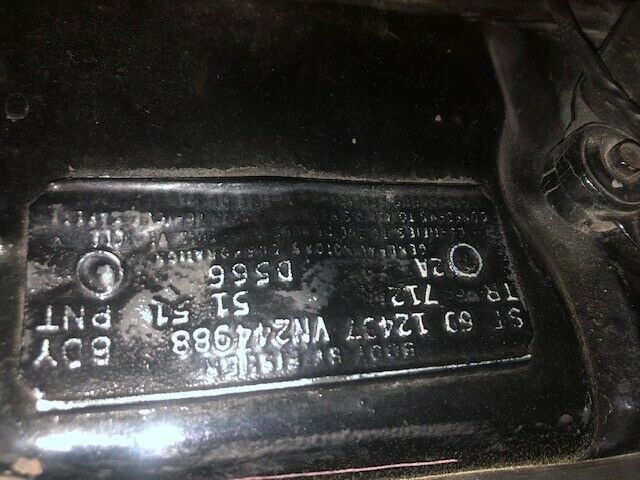

Looks like the guy at least amended the ad:
"I have had a couple of people state that the build sheet and window sticker that I have presented are not original. I was told when I purchased the car that they were original, appear to be so, and I have no reason to think otherwise. But no, I cannot definitely prove the sheets are original, but I am not intending any fraud here. I have described the car as accurately as I can and the car is an original SS big block car. I have a picture of the trim tag as well. Please contact me and I can send it if needed. Or contact me with any other questions."

The number 244988 on the tag establishes that the paperwork is fake; it should match factory paperwork. 361713 is from a much later car.
