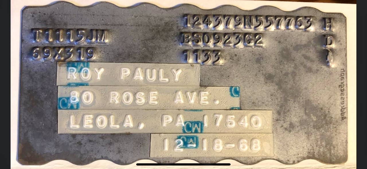

Saw this on FB:

Weird to have a 3.31 gear paired with that engine.

06/15 CRG thread w/ Subject VIN Vehicle...
http://www.camaros.org/forum/index.p...&topic=13479.0
124379N557763

Guy named Denny bought the car in 2001 and apparently still owns it. Trying to give his totally faked car (even stated in 2002 that he "made" it an L-89'.... now says the POP is "original" to the car.
Fortunately there is a trail on line.
Here: https://www.camaros.net/threads/is-t...e-money.26216/ at post #13.
and here: https://www.camaros.net/threads/69-codes.22796/
Tag did NOT have X22 on it when purchased in 2001.
Denny: I hope you weigh in here. You are busted man.

He calls a POP a trim tag ??
Very interesting read on CRG..thanks Pete !

Something smells....

I am so tired of the bottom sucking scum that this hobby has created, all in the name of lining their pockets and scamming other fellow enthusiasts. Its no wonder so many people have gotten a dirty taste from it. Hopefully these people get what's coming to them some day.

Denny B is being challenged on FB on his protecto plate and story. I'm guessing his OP will disappear.

That's me asking him about it.
