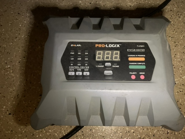

Originally Posted by Charley Lillard View Post
Just a heads up...The repo batteries that are really AGM inside of a old water filled looking case should not be trickle charged. If you want to charge it they want you to run it down with te headlights and then do a full charge.
This charger/maintainer works great on AGM batteries. It features an exercise mode that discharges and recharges AGM batteries. I have two Chevys with AGM batteries and use this Pro-Logix charger between them.
Rick
