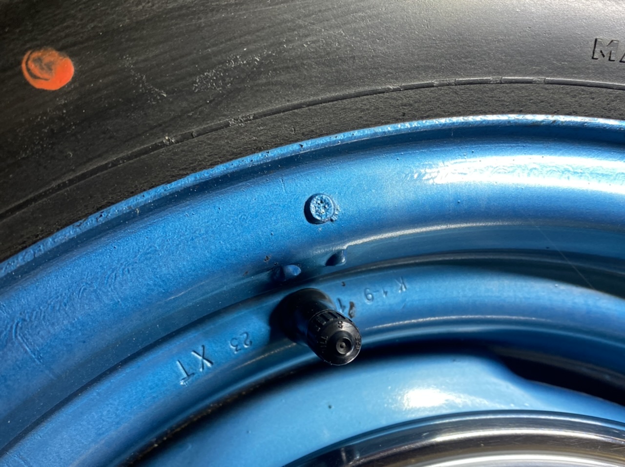

Can someone explain these dates ?
Attachments - The Supercar Registry D4622D04-C039-4484-B66E-6874B9D0B751.jpg D3EEB96A-410A-4F29-9AB7-4D5B869A9289.jpg BDEF7C1D-3A42-4588-A785-12124C2FC44A.jpeg B01795C3-3618-4E63-86A9-C74344BCFD74.jpeg

Hi. 37th & 45th week of 1992, 1982, or even 1972 maybe.
I believe four digit dates (last two of last two of year) started in 2000.
They’re at least nearly thirty years old.
Cheers.

Last photo above is 48th week of course, exact year ending in “2” still unknown.

Goodyear Polyglas Tire Date Coding:

Those tires were made in or after 1971 which is when the United States Department of Transportation mandated all tire manufactures use a standardized 10 digit DOT Tire Identification Number.
Goodyear Wide Tread GT RWL tires which came on 1968 and 1969 Z/28s will not have that DOT + 10 digit number sequence
