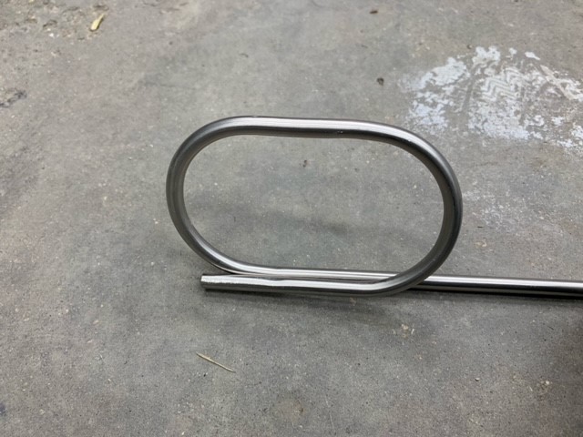

Starting into a 3" SST exhaust job on my mini-tubbed 72 Nova. Going to use the 3" PYPES Chevelle style tips out the back. I made rolled edges for them, thought I would share.
I know the welding is a mess but I'm just learning the Tig and SST is a little tricky for me still (need to make a back purge system).
Gary

Thanks Guys. An experienced welder friend advised I should try a smaller electrode (1/16") to get better control of the arc which would allow a smaller weld and better heat control. With the 3/32"electrode I was finding I needed about 27 amps floored to get started then even backing all the way off on the pedal was still getting too hot and burning in after about 1/2" to 3/4" travel. So I had to do it in stitches.
