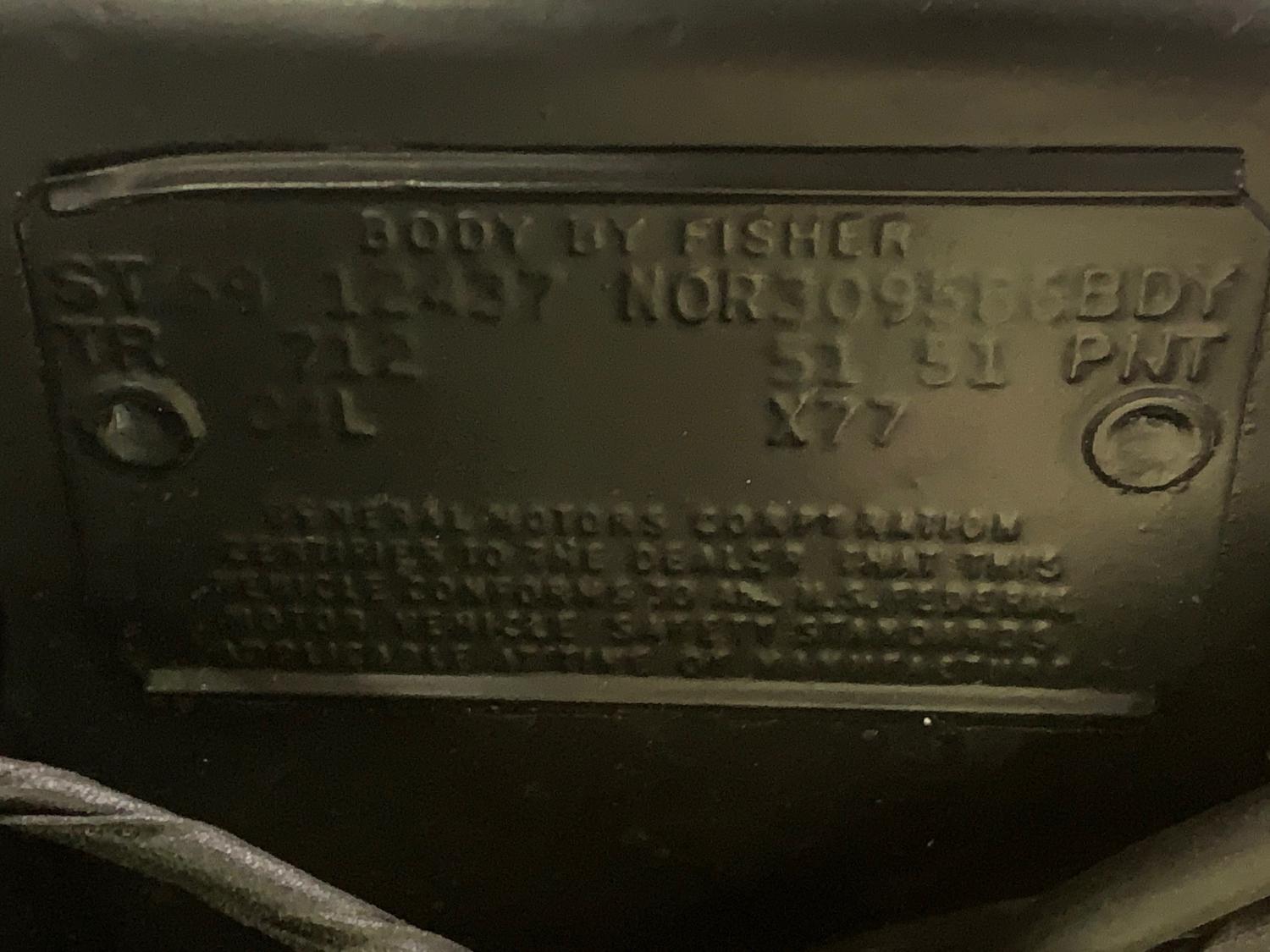

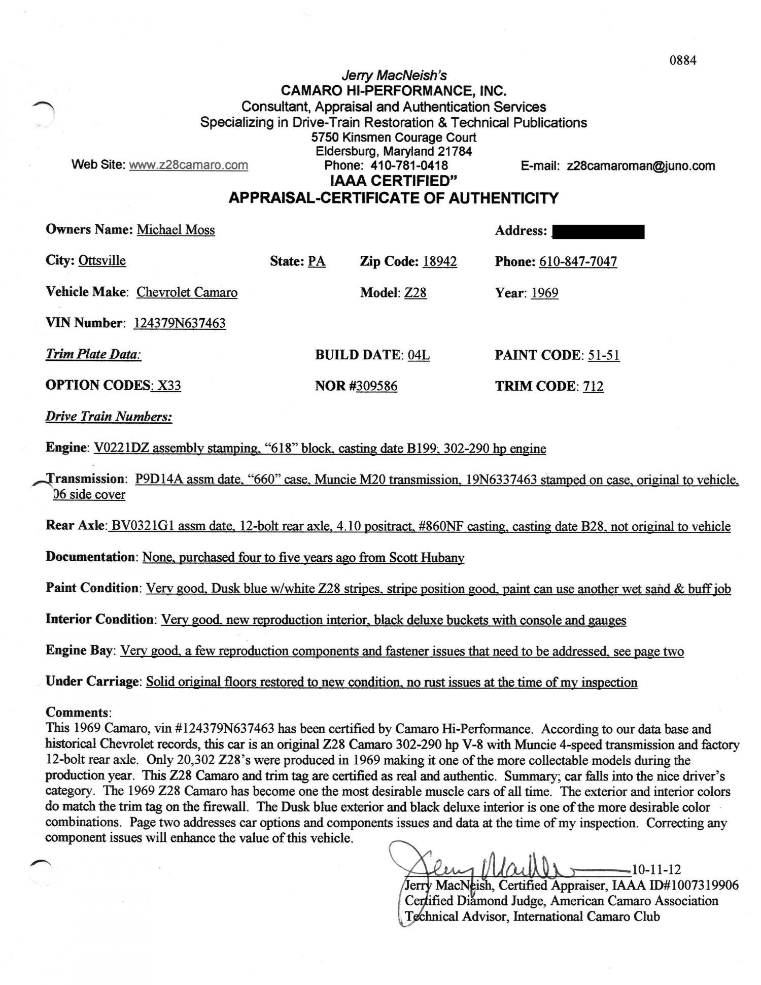

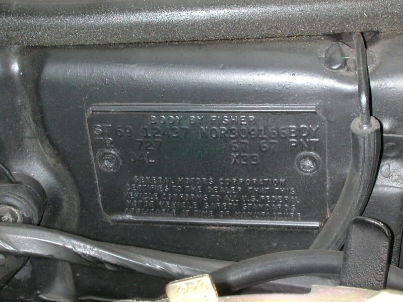

Here is a picture of the trim tag. I believe it was part of the original post, but in case it was not, please see below.

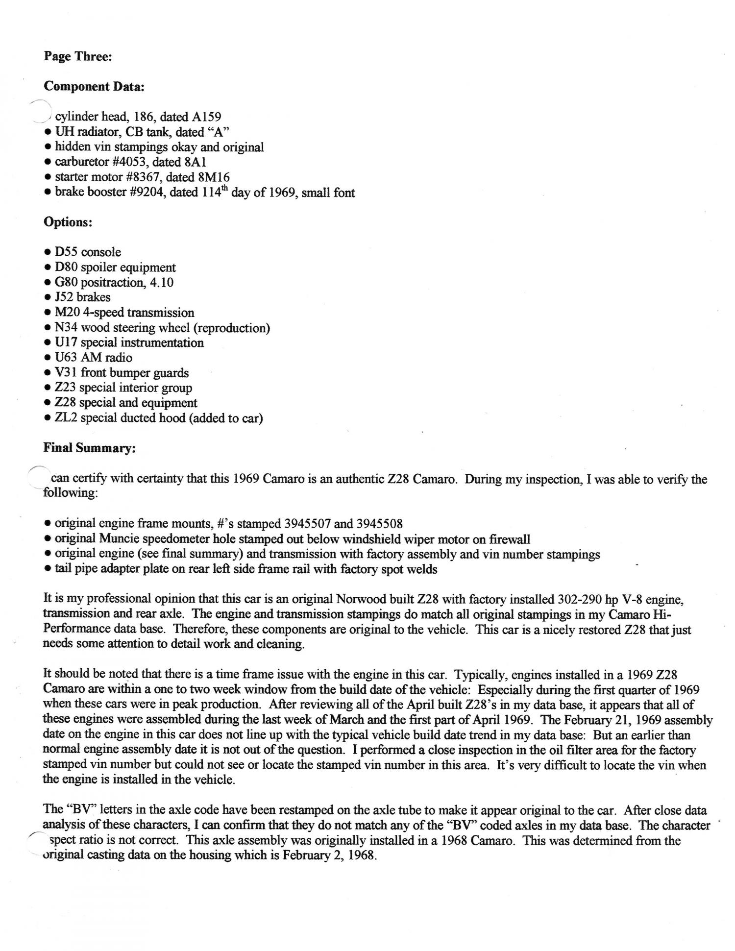

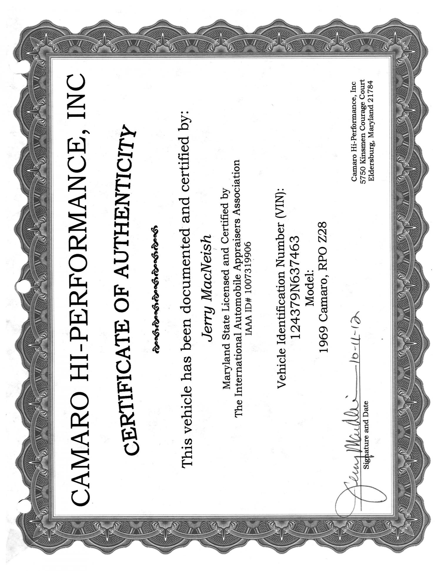

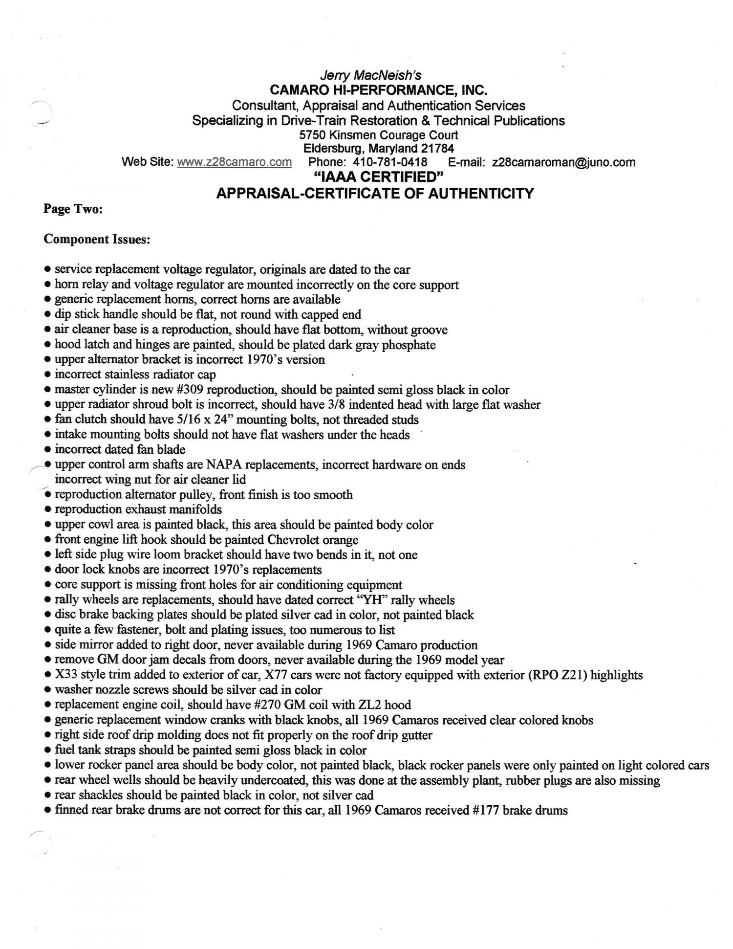

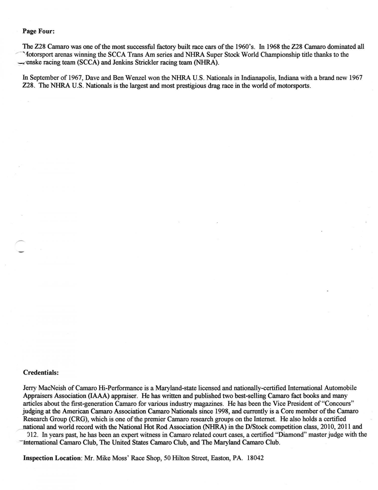

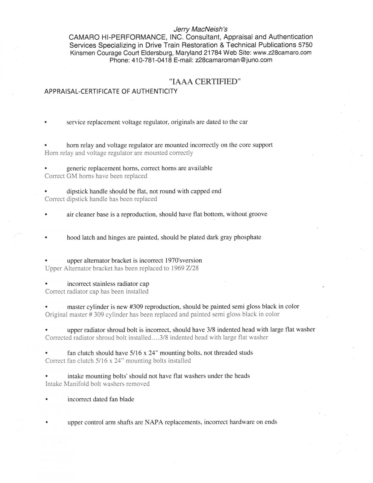

I am also including pages 2-8 of MacNeish report.

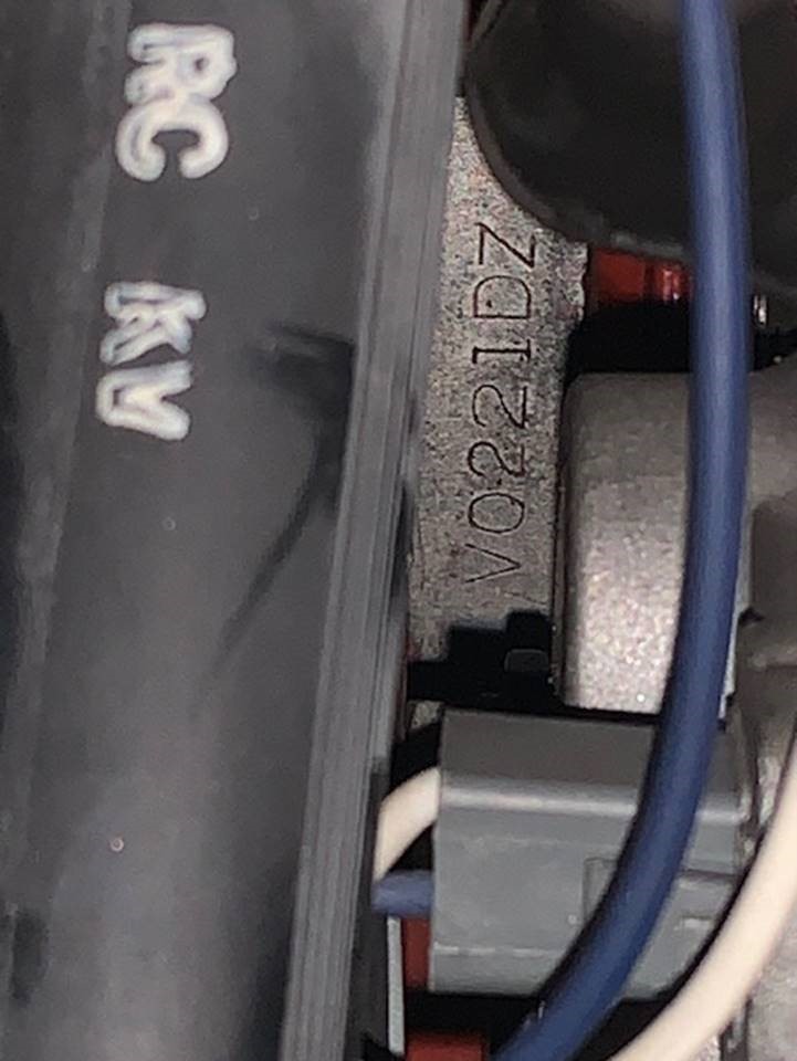

Good of you to post the report and it appears you have corrected many of the little things. I agree with the engine being too far apart. In fact, that block is perfect for my 02D car built in February. Correct YH wheels would help the cause and help with its value and integrity.
Nice car. GLWS

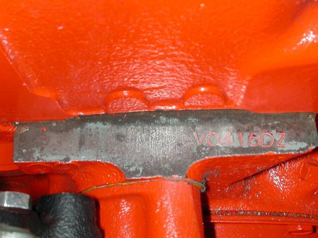

My old 69 JL8 VIN637170 with the 04L trim tag & engine stamp V0416DZ.

69L78 and dannystarr are simply trying to be helpful....please post as requested ....potential buyers would benefit from seeing Jerry's list of nonconforming findings....provides data for estimating additional dollar outlay following purchase....Nice ride!

It is already posted above and is there in black and white!

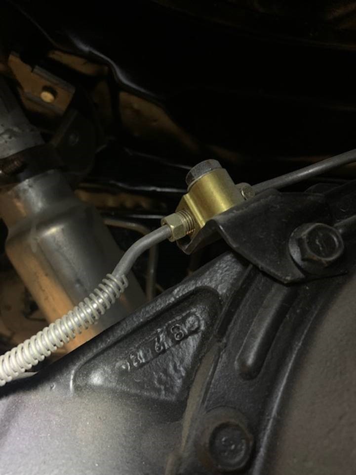

Mike did send me the other pics of the pad, trans & rear in a PM

Pics

I think that Jerry's reasoning on the block isn't very solid...
