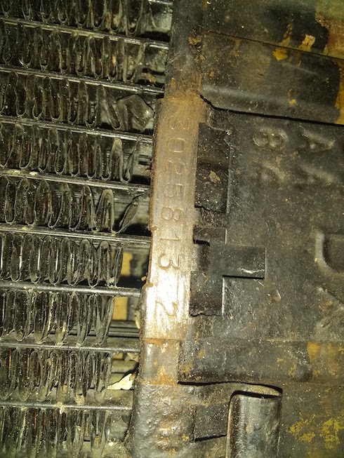

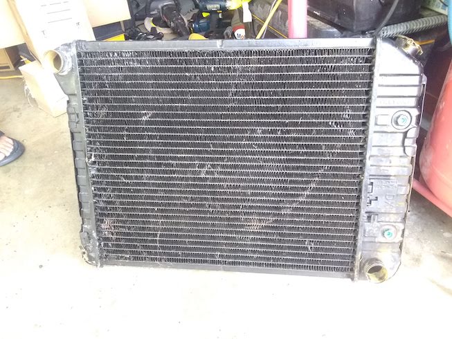

Core measured 21" wide. Hopefully you all can help me decode this I have no idea.
Thanks!

I have a guess, but first what is the number on the bottom edge of the tag? 3025813?

Kurt,

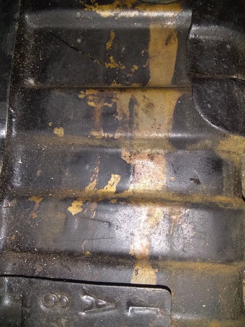

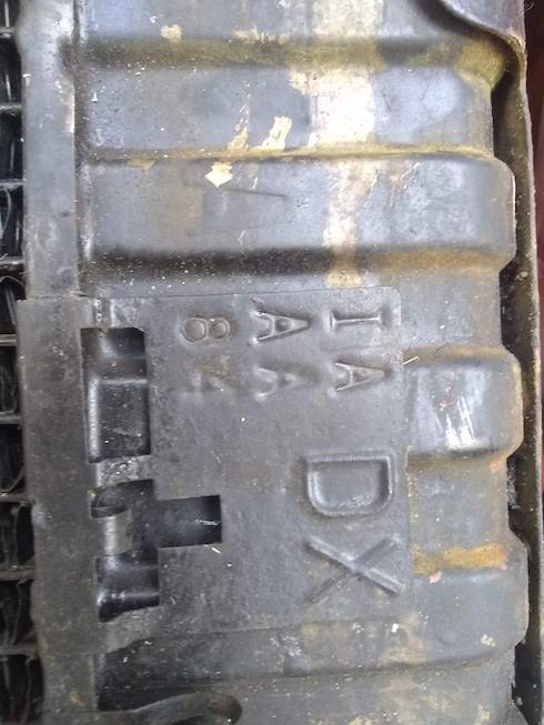

Yes. "3025813 2" I also noticed AA on that tank. Pics attached. Thanks!

Thanks for confirming the number. I wasn't sure on it. I can't find anything on the number, but it's a mid-70's Chevy. Pretty sure Nova.

L1 in the depression between the AA is the date code - December 1971.
Wow good eye. Didn't even notice that and learned something new. Thanks
It could be from a '72 Nova 250,307,350. That part number does check out. Hmm... I'm going to let this radiator go but want to advertise it correctly.
