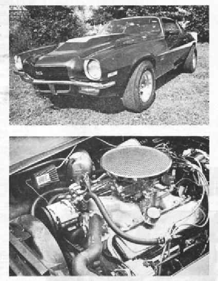

Default Fly Eye Air Cleaner
I'm in need of a low profile (very low) air cleaner for my son's Corvette. Thinking that a Fly Eye would be a great Day Two option. Does anyone know where an affordable re-pop can be had? Not sure that I'm ready to cough up for an original.

Just a heads up on the fly eye. I ran a Cal Custom on my stock 1969 L78 Camaro and found out quickly the top was about the same height as a stock open element air cleaner. Both would rub the hood insulation. The fly eye started to cut a circle in it. The air cleaner was NOS and the instructions on the box stated not to use with the hood insulation.
I removed the insulation.

Make sure your car has good fire insurance if you go with a fly eye.
One little backfire and the foam has a habit of going up in smoke.

And at the very least making a mess of your carb...

I think the zig-zag wire goes between the two mesh screens? I see some with the zig-zag wire visible and some without.

the zig-zag wire holds in the mesh screens and filter.
the zig-zag wire came later
the early fly eyes had a large chrome snap ring to hold in the mesh screens and filter
